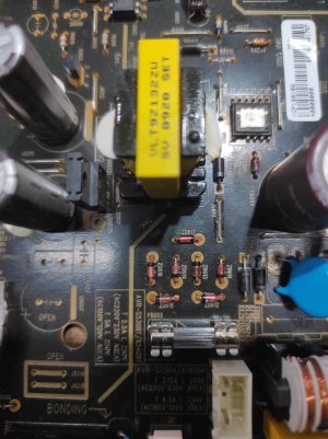

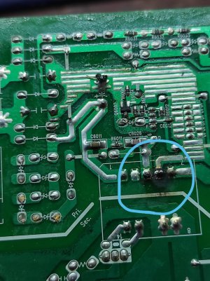

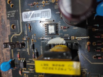

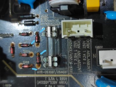

Hi , i am also living in kerala and what you have said has happened with me very recently. Due to moisture some components of the board is corroded. Technician sent me pics of the damage caused. I am using denon 250 bt. Moisture is a bigger worry now than the dust. I just stumbled upon ur comment. Can any one suggest any solution or precautions to be taken.
