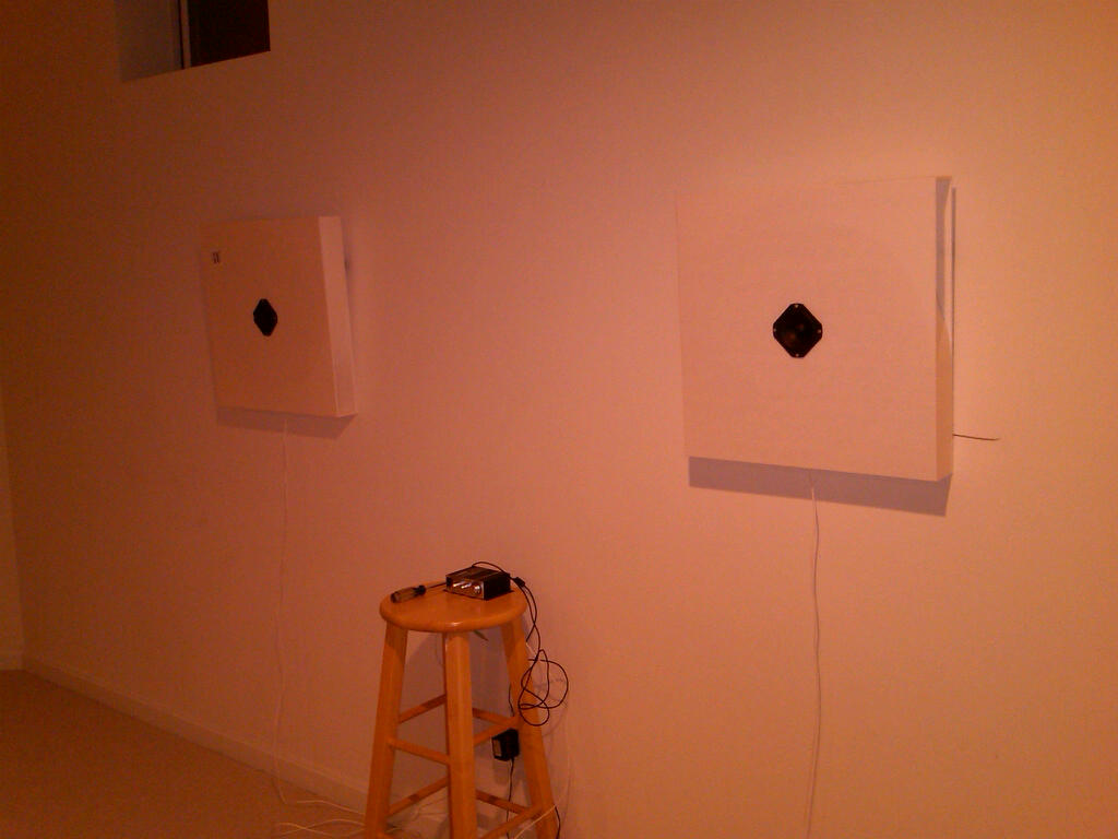

If your placement is on the wall then a shallow enclosure will be able to utilise the wall as a 'baffle' for extending the lows.
No matter what driver you choose, one thing is for sure, a driver against the wall will need Eq. And once Eq is done by measurement the low Xmax of the driver will be compensated by 'boundary enhancement'.
See th wall mounted Cornu Spiral speaker build at diyaudio.com
https://www.diyaudio.com/forums/att...lding-cornu-spiral-horn-cornu-06103432579-jpg
