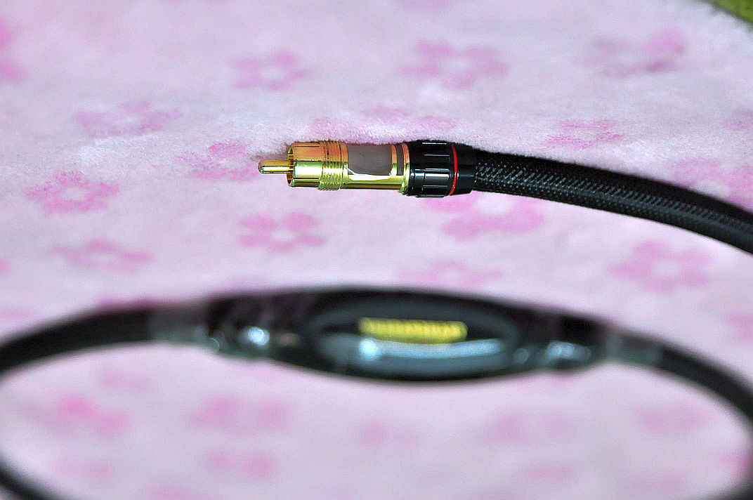

Lately I discovered that my one channel of my most useful interconnect Transparent Audio MusicLink Super developed some problem. Late at night when it's dead quite, I can hear a very faint hiss from one channels during pause between songs. It's not really bothersome but I would like to get it fixed if possible.
While trying to find out if there was something obvious that I could see and fix, I opened the outer shell wanting to see if one of the connectors had come out loose or something. To a pleasant surprise I found out that the connectors are injection molded. Means, any DIY effort is out of question.
One option is to send it to Transparent USA for fixing. But I would like to avoid the route due to obvious reasons. That brings me to the question: does anyone know who can fix this in India?
Had it not been an injection molded, probably a lot of people could help, but with injection molding? Anyone does interconnects like these in India who can fix my IC?

Are you sure it's molded? Not hot melt glue? I'm asking because I've seen commercial cable connectors filled with hot melt glue and some filled with resin. They claim it "damps" the connections. :-)
I have isolated the problem by disconnecting all components and connecting back one by one. I was suspecting EMI from one of nearby power bricks to be at play. But after nailing things down component by component it came down to this IC. If I swap the IC the hiss moves to the other channel. That confirms that the problem indeed is with this IC, the other one in the pair is just fine.
I do suspect it could be a problem with the draining. Seems like the drain and negative are shorted at one end. But I don't have a multimeter at hand. I'll get it tested by someone and get back.
@Keith, not really sure mate. When I opened it the first word came to my mind was injection molding. But you have a point. It may just be hot glued with an appropriate material.
The photo I posted was hi-res. I guess I should post a hi-res photo to give a better idea of the same.
Poke it. If it gives, it's probably resin. If it does not and if you can easily prise put a tiny chip it's probably glue.

Btw, here are hi-res pics. Better view of the connector.
If I point the nail on it and press hard, it makes a mark, but it's a solid feeling off-white color stuff.

Looking at the photo, I am sure it is not injection molded.
Thanks! What is it then? More importantly, how to remove it safely without damaging the IC in order to fix it?
Is it hot glue? Will it come off if heated? How do I remove it in order to check the termination?
