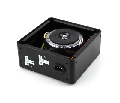

I introduced isolation transformer in my system long ago but recently tried something called Balanced Power from Equitech and this is something I cannot live without. Voices and instruments have taken such a nice shape that is making music sound so realistic and the noise floor has gone down drastically.
I would forcibly encourage you to read about this - you can start from Equitech and then I see some available from China too. Please check out the links below; whatever reading I have done so far indicates that these do both - isolates and supplies balance power to the system and benefit is seen mostly with the equipment running on 3-pin AC supply.

If they are available in India or not will something have to be researched (by you :)) but you can certainly try the one on eBay from China and trust me that the change it has shown in my system is just so good and I am very confident that it will help you too.
The Equitech certainly looks very nice. Unfortunately it’s not available to buy in India. You haven’t tried the Chinese one from eBay right?
