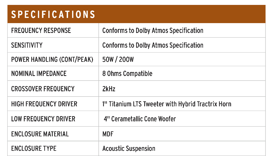

Been running thru the specs of RP 140 SA
Freq Response : Conforms to Dolby Atmos specification
Sensitivity : Conforms to Dolby Atmos specification
Dolby Atmos specification for sensitivity ? [emoji15]
Klipsch could have very well mentioned it simply.. is it indirectly conveying that it is Atmos speakers? [emoji13]
It's marketing at work. People who don't understand specs get influenced by the names like Dolby,DTS, 100000 WATTS and what not.
Dolby specs are 105 db SPL for low freq's.101 db SPL for mid's and high's ,freq response 40hz to 16k Hz for fronts,80hz to 16k Hz for surrounds.

Dolby Atmos speaker specification - http://www.dolby.com/in/en/technologies/dolby-atmos/dolby-atmos-specifications.pdf
Though the surround speaker freq resp is fine, these specifications are for movie theater..
How do i calculate the sensitivity of this speaker? Isn't 101 db SPL high for home? :sad:

The spec link you shared is for movie theaters.
For home theater use if you get 85-90 dB SPL at listening position, with a 6-10 dB headroom for "masala" scenes, you are good.
For living room home theater, even 85-90 dB SPL is high.
After one watching one movie at these levels, you need to go sit in an abandoned temple or monastery for quiet time.
So don't worry about these numbers, let the AVR do its calibration and magic. If necessary tweak on top of this calibration as per your liking
Given that Klipsch are high sensitivity speakers, your AVR will be one cool cat. Needs to burn only a few watts to reach high SPLs.

What raghupb said. Also it depends how big a given room is. If you have a large room you will have to crank it up, for average room size they should go loud with just a few watts.

Thanks Raghu.. Yes. The specifications are for movie theater, but not home... Dolby specification for movie theater can be misleading for home theater..
Going by the RP range of Klipshch, i guess the sensitivity of the speaker should be anywhere between 93 - 97db..
Anyways will drop an e-mail to Klipsch to see if i can get clarity on it..
