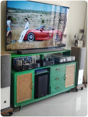

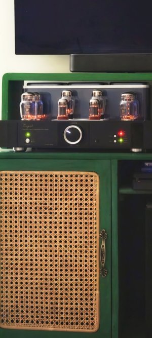

Enamored by the Boyyurange EL 34 Tube amp (fitted with Mullards EL34, GZ34 rectifier and Russian 6HI), I was convinced that for the songs I prefer, this sounds best.
So I decided to let go of my Rega Elex Mark IV. Instead of a sale, I got an offer to exchange it with a Cayin A-88T MKii. I took the bite. That things looks gorgeous.
However the Cayin sounds very unlike the Boyyurange. Fitted with Sovtek KT88, Ps vane UK6sn7, Tugsol GTB 6sl7, it sounds clean, clear and precise. Unbelievable midrange clarity and base and treble extension. Demanding songs that needs drama and dynamics, it sounds great.
However, in comparison with my other tube amp, there is total lack of warmth and tonal richness.
This was partly remedied by swapping the input stage with Russian NOS 6ns7 and 6sl7.
I wanted to know, whether there exists a KT 88 tube which is on the warmer side of things.
How about Mullards (new production KT88) ? My go to tube dealer has also suggested a very rarely used CV345 (aka 12E1's) as a drop in replacement for KT 88? Any experience?
Cayin does come with a EL34 selector, however would want to retain the dynamics of KT88 and looking to get some bloom and warmth to go with it.
Recommendation and suggestion are really welcome.

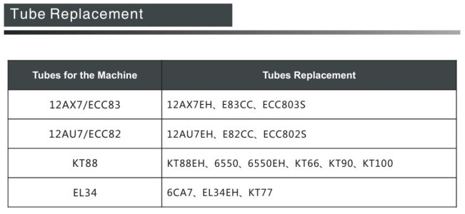

Also, as @yogibear correctly points out, the CV345 might cause problems. Below is a recommended tubes list from the CS 55A manual. No mention of the ‘345:
