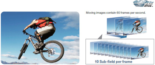

TV companies often advertise their products as 120 Hz etc to say that their TV handles motion better. Recently, Pana has been blowing the whistle saying their new Plasma are 600 Hz Sub-field drive
1. Is a 120 Hz of a LCD better than lets say 600 Hz of Panasonic Plasma or is vice versa?
There is no comparison. Both refer to two different technologies and are mean for something else. In Plasma TV there are 8 or 10 sub fields. Each sub field refreshes at 60 frames per second which basically gives the number 10 sub fields X 60 fps = 600 Hz Sub Field. This results in better picture. Our eye will not be able to spot a difference between a 480 Hz (PV8) or 600 Hz (Latest Plasmas). So don't worry about this.
In the LCD world it makes a difference as the better the refresh rate better the PQ and lower Motion Blur. You see this better when you see a news ticker, a 120 Hz one will be more sharper compared to a 60Hz. This noticeable during sports. 120 Hz infact helps to show a 3D ish image.
So pls dont compare 120 Hz to 600 Hz, they are completely different. LCDs are still trying to catch up with Plasma on this.

What is 480 Hz sub-field drive?
A standard video signal is actually a series of still images, flashed on screen so quickly that we believe we are watching a moving image. The typical frame rate used in North America is 60 frames per second (60Hz) meaning that a TV would display 60 individual still images every second. Sub-field drive is the method used to flash the individual image elements (dots) on a plasma panel. For each frame displayed on the TV the Sub-field drive flashes the dots 8 times or more, meaning that the dots are flashing 480 times per second (480Hz) or more. (Example: 60 frames per second x 8 sub-fields = 480 flashes per second).

well the marketing guys won't have much technical no how.the 600hz subfield makes 2009 FHD panasonic plasmas to achieve full 1080lines of motion resolution.

I dont get how motion resolution has anything to do with the the subfield driving. Since we are repeating the same image multiple times (with varying intensity to produce colour gradations).
So, I guess they have improved their electronics and then attributing it to 600Hz ...
