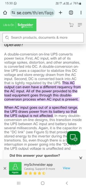

Double conversion ups is
AC - DC - AC
It is connected to the mains and depending upon the smps converting the AC to DC,EMI / RFI noise from the mains could still get into the system. The battery power is tapped only when the mains power is not available.
In ecoflow, the battery is charged before use and it is then disconnected from the mains. So no EMI/RFI creeps in.
In battery mode, both will be similar.
You are right about AC - DC -AC double conversions in double conversion ups.:)
No offense, but it is incorrect that battery power is tapped only when mains power is unavailable. That happens in offline and line interactive ups, not in double conversion ups. That is why these double conversion ups are called online ups. If there are any offline types of double conversion ups, I am not aware of them. I am no expert here, just an enthusiast like Murugen was an enthusiast of CSK. :)
Please go through different types of ups here.
Yup
I could be wrong here. I thought all double conversion ups operated like this screenshot. The terminals of a battery are same for charging and drawing current. So this concept as shown in the SS made sense.

Thanks. I thought in a double conversion ups the output is always from the regenerated AC. Never from the mains.
