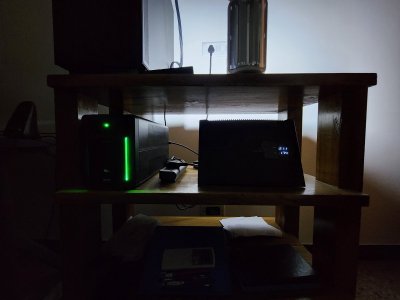

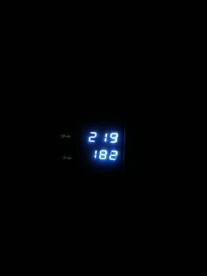

Just now I had a power outage and I tested this combo. I connected my APC UPS 1200LI to my Vguard Voltino max stabilizer. And input voltage is stable at 180 as shown in the stabilizer and stabilizer is boosting it to 219v.
Just for you guys to be clear. I have take a picture by placing that stabilizer beside my UPS with just power from the battery. Placed an emergency lamp on top. when the power comes back again will do another test. If the voltage is still 180v then there is no point in using stabilizer.

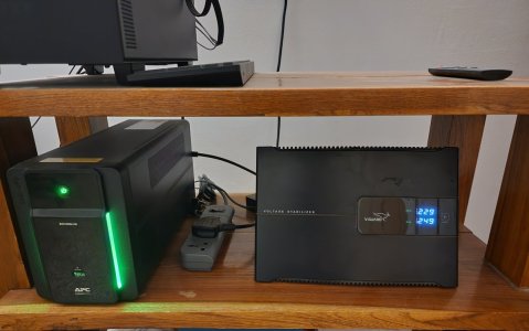

With Power Back on. It's same like plugging into the wall. Looks like online ups is a better option. Experts please suggest.
