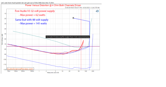

compared to the rated power off 300W @4ohms the ASR bench test revels a mere 140w @4ohms max power.
Never knew 140w equated to “mere”. But generally speaking, none of these amps truly achieve their fully rated power and the ones that do are at 10% THD. In any case, it would be nearly unreasonable, unless they hadn’t claimed so, to expect 300W x 2 from that tiny a form factor.
The Marantz M1 i use produces a solid continuous 100W x 2 @ 8 ohms <0.05% THD but it is nearly 4 times the size of the V3 despite being a compact Class D amp itself.
The Fosi ZA3 in monoblock config may be able to achieve 150w x 2 @ 8ohm but thats 26k and one too many wires.
Topping products should be able to achieve the rated power they advertise. Topping LA90 can do around 60w x 2 @ 8ohm but when switched to mono, its nearly 200. Same with Topping B200. Check them out but a word of caution - you’ll need two units of either to run stereo while achieving the desired power output.
I was supposed to get 300 watts, so that’s why I said “mere” in comparison.
Those are the pitfalls with cheap Chi fi amps. I also run a Kinki Studio, which is also a Chi Fi amp and weighs the better part of 25 kilos, and it only produces around 280W @ 4ohm. Two units of Fosi ZA3 in monoblock config is still your best bet but chasing power is meaningless so i recommend you look at the SMSL or the Aiyima T10, power figures be damned.
