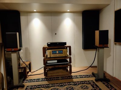

white textred wall paint
still some acoustics left
a ceiling cloud
a rear absorber
a frontal lean fractal diffuser

the traps are infact upto ( upto the top edge ) the ceiling
A beam protrudes out so i can carry the trap forward and back up again
as for why they arent floor touch ?
well simply because i wanted the floor space
about the traps
P.S : the bass traps are true traps with 3 sperate materials , an air cavity and a diaphram - they are 6 inches thick and not light
they take up too much space when mounted at angles
though you should note that
they were initially at 45 degrees
they seem to work almost the same when kept flat
i found marginal to no differnce in angle mounting

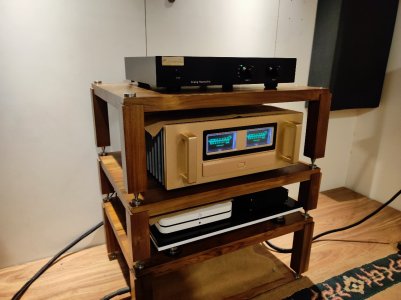

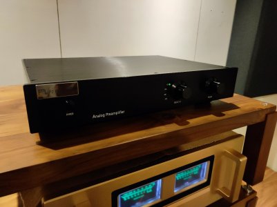

Back to minimalist
After going full circle
Back to minimalism
Bluesound
Gustard a26 2 box ( test version )
FNL pre
Sfa 60 class a 60 w power amp
Personally my favorite sound yet in my mini room
