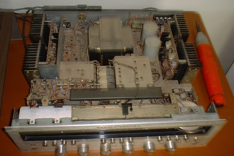

Since I posted about my Marantz 2270 restoration project in
this thread (post #16), I thought I'd post the completed result in
the same thread).

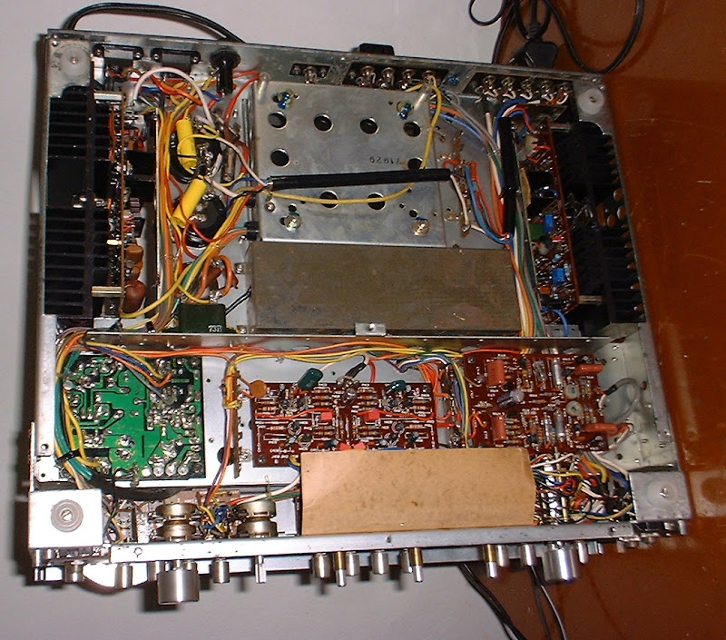

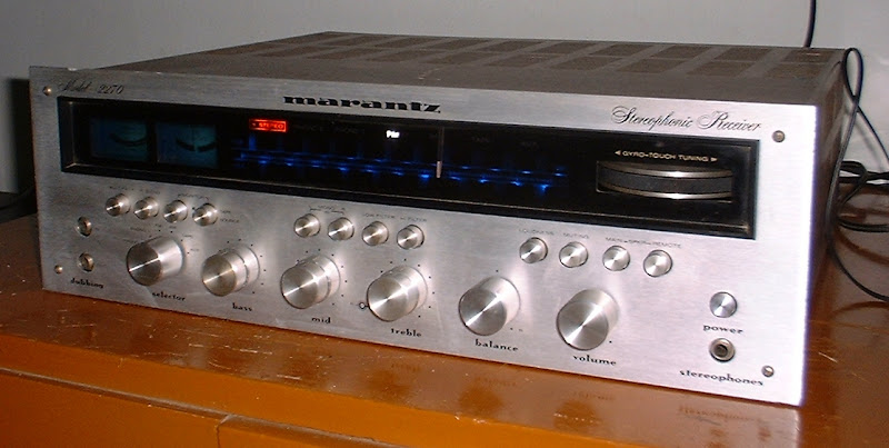

I started with this -

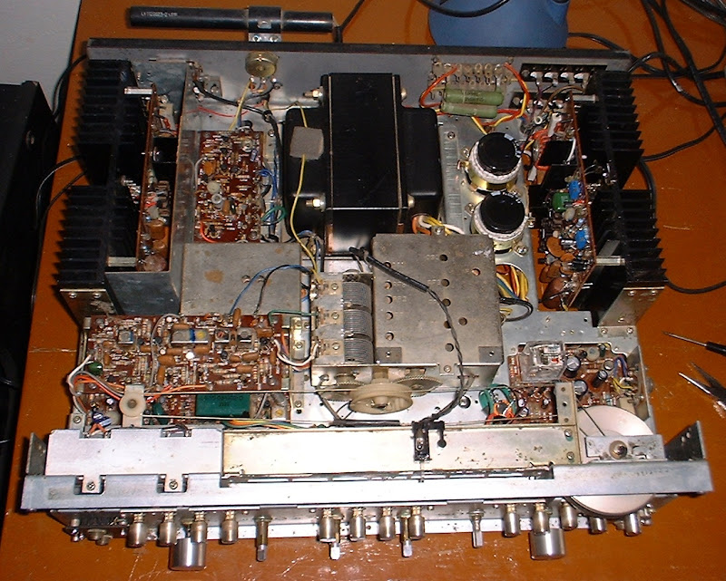

After replacing nearly 90 capacitors, 10 diodes, 25 transistors (phono
board + rebuilding of damaged power amp boards),
it looks like this ....
More pics here .... (I'll update the album later with the pics of the
refurbished WC-22 original, wooden case too).
https://picasaweb.google.com/prasadb/Marantz2270#
wow!!!!!! Wonderful job.
Can we have dedicated thread for this. How did you clean PCBs ??? Did Tuner section required setting ?
Wish I had skill like yours. Great job quad.
WOW! awe-freakin-some!
can u do the same for my Sansui????
I now have a new respect for service technicians.
This project took up so much of my time.
Mostly learning a lot of Marantz circuit and service info, and lots
of time spent searching for replacement parts. For the caps, I
was really lucky to get Wima, Panasonic, Elna and Rubycons.
They really packed in those circuit boards, with short wires too.
And the damn thing is so heavy, every time I needed to flip it
over, I had a backache!
Fun, yes, but don't really want to do it again.

Thanks, Hiten.
Circuit boards took nearly one bottle of iso-propyl alcohol, a pack of
Johnson ear buds, and so much of time. Perhaps this is the only time
it helps to be a obsessive compulsive type. Else would have given
up long ago :lol:
Tuner section - fortunately, it didn't need realignment. The original owner
said when he brought it to India in the early '70s, there was no FM.
When FM started here, he tried, but it never worked for him.
I suspect my cleaning of all the contacts and replacing the caps fixed something,
as everything works perfectly now. *Touchwood*
