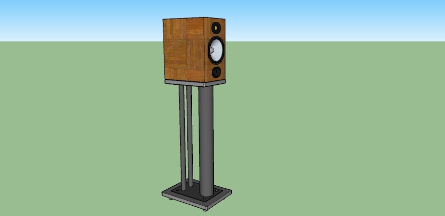

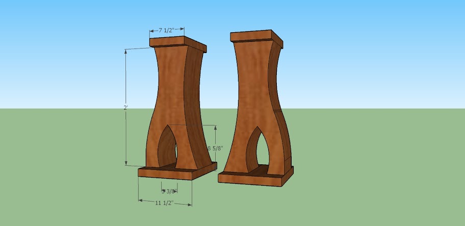

Design - Phase 1
I initially started with this design:
But, wife said no - as they don't look gorgeous. Then we started to find beautiful (:)) speaker stands in google images and finally she selected this one:
(image courtesy google image search and foter.com). I liked the design as well and started the design with sketchup immediately.
Design - Phase 2
Finally, I came up with this design and it literally 'put a smile on her face' :yahoo:

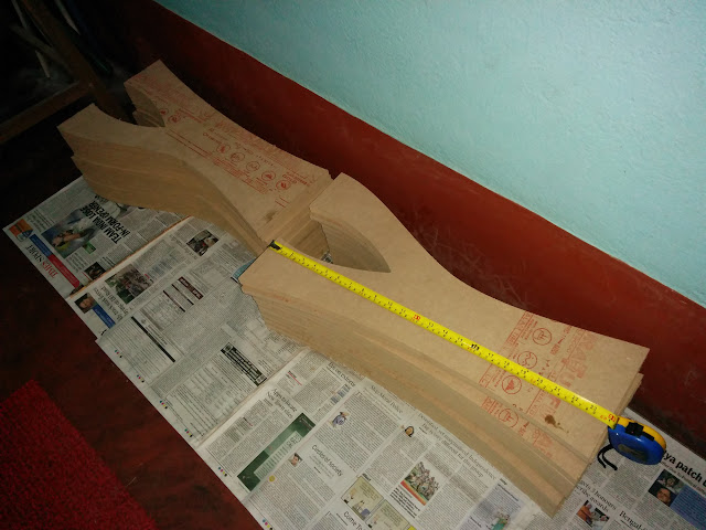

Build - Phase 1

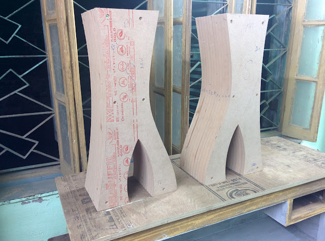

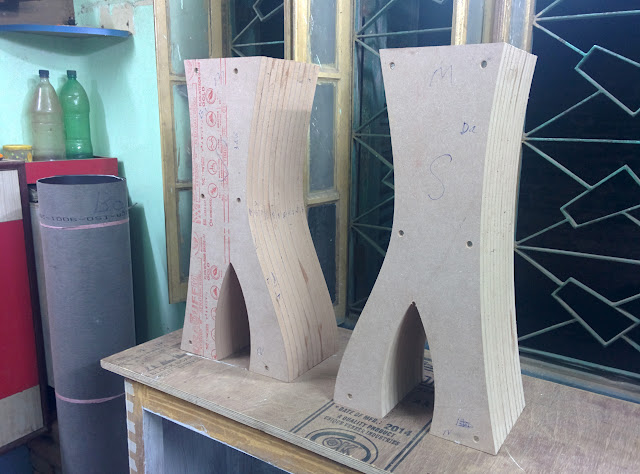

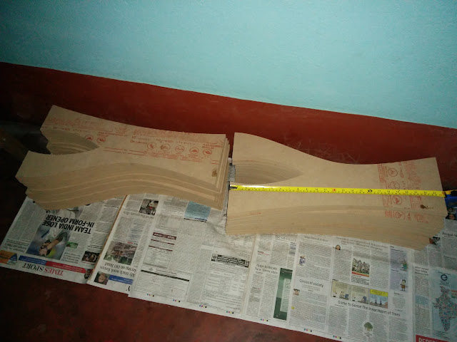

Build phase was basically locating the CNC workshop and provide them the design, raw meterial (17mm 8'X4' MDF boards - i purchased two of these) and of course the advance payment (:)). The final sliced pieces were delivered today evening. Here are the images:
There are total 22 slices of following dimensions:
Height: 24"
Bottom Width: 11.5"
Top Width: 7.5"
If I paste 11 slices together, the depth would be close to 7.5" - which is exactly my desired dimension.
This is the update so far. And the story continues...............

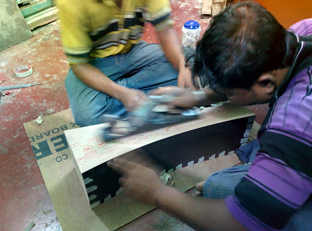

Build - Phase 2

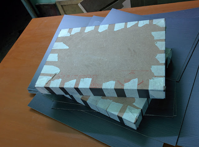

I contacted my local carpenter yesterday. He asked me to drop the slices and the laminate at his doorstep.
The finished product will be delivered in next 4-5 days

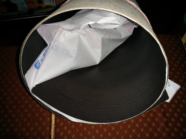

BTW, I almost forgot to post the pic of the laminate. Here it is:

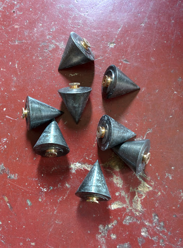

Build - Phase 5 (Procurement)

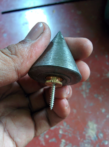

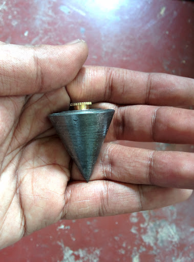

I was a little confused about the spikes to be used. When I showed the spike images (from diyaudiocart - I intended to order it first) to my carpenter he came up with an excellent idea.
"Why don't we use plummets ('olon' in bengali) for spikes?"
I thought for a moment and decided to give it a shot. I have shared the idea with some audiophile friends in Kolkata. They found it to be exciting as well. :)

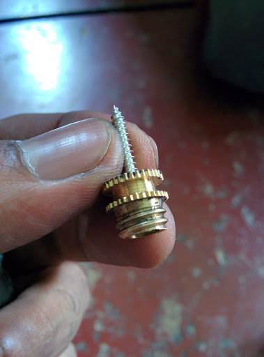

I purchased a set of 8 plummets from local hardware store. Here are the images:
Excellent lateral (or is it vertical?) thinking to use those plumb bobs
as spikes
I am glad that you liked it. In my case I purchased those @ Rs 25/- each.
You cannot go wrong with it at this price point. Atleast its a (BIG) bang for buck. :yahoo:

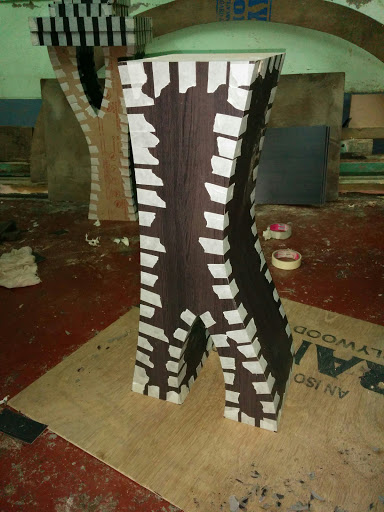

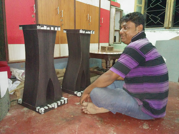

Build - Phase 6 (Getting there)
Creator with his creation.
BTW the name of my carpenter is Amit.
Expected delivery is on Thursday, 27th. Fingers crossed. :)

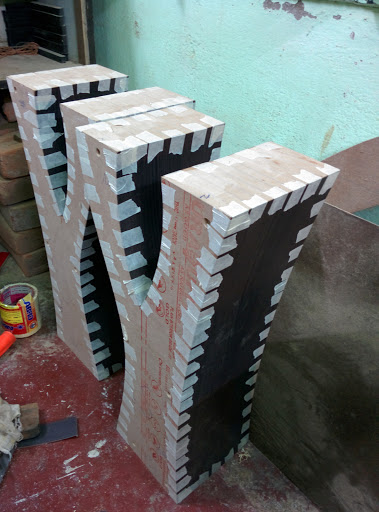

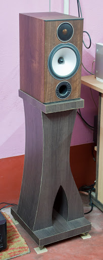

Build - Phase 7 (The final chapter)

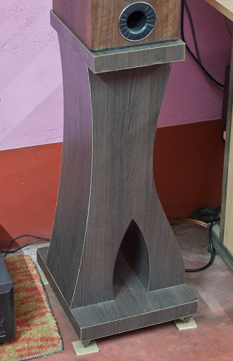

Finally the wait is over! :clapping:

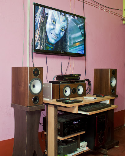

After burning a significant amount of oil (petrol mostly) and few kilo calories (:lol:) I received the final product. Let me present my new babies at home.

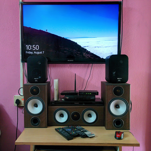

With speaker:
This the whole setup:
I know, the computer table is not blending with the speaker stands. I am planning for my HT room in next 6-8 months (fingers & toes crossed). Then I will replace it with new AV furniture (that is also designed by me - will post the photos for the same once the room is complete)

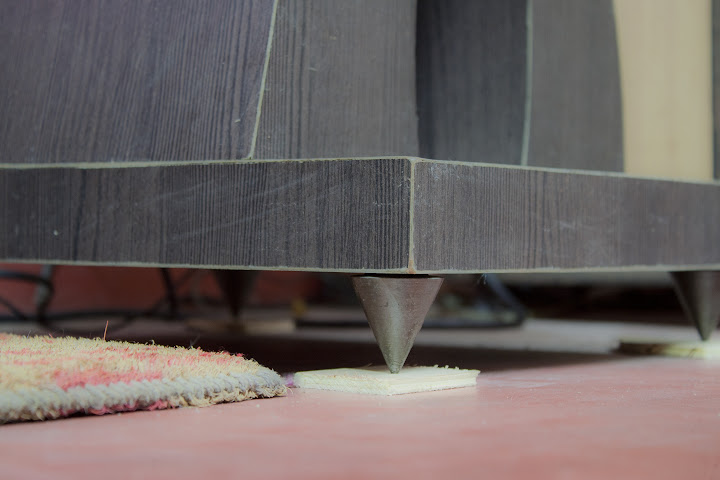

Last but not the least, this is the speaker spike (plumb bobs) assembly:
Currently, I am using 4 pieces of plywood pieces as base plate. Will purchase carrom coins this weekend to replace this stop-gap solution.
