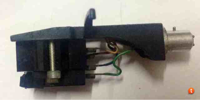

Are you swapping carts on the same headshell or do you have separate headshells? Humming noise can be caused if (1) the headshell leads are not making proper contact with the headshell connector pins or the cart pins, (2) if the headshell does not fit properly into the tonearm headshell socket, (3) your cart is wired incorrectly and (4) if your cart is faulty (this is assuming that your TT is properly grounded as the other cart works fine). If you are using the same headshell and swapping carts, check if you are wiring the cart correctly (Shure pin congifuration is different from others). Here is a typical example of the shure pin configuration:
If your pin configuration is correct, and the wiring and circuit is perfect, then you may have a faulty cart (with open internal wiring)

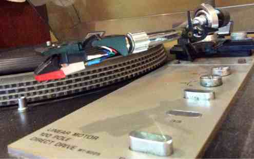

Bought a vintage turntable, the Studio Standard by Fisher, Direct Drive, Model MT 6225 from Shafic to embark upon my vinyl journey. Have hooked up the turntable to my stereo listening system with the Marantz PM 6004 amp and the KEF Q 300 bookshelves.
Sounds great, need to clean my LPs to get rid of the pops, otherwise everything is good!

So, I bought a new cart, the Shure M44-7 and a new headshell , a Technics one from Amazon USA. The dreaded hum is back, starts on switching on the TT . Mind you , no hum still from the budget Altai cart! Also, when I tried out the new cart with the Marasim LP, the instruments sound is good but the vocals are barley audible. What is wrong here?
I did the usual stuff, float the tone arm , add a tracking force of 2.5, etc.....

Since you are using different heasshells, could be that the headshell with the Altai cart gets seated correctly on the tonearm mount where as the other headshells done (misaligned pins,etc..) Try running the humming headshells on some one else's TT or swap out the Altai cart with the new M44-7.
