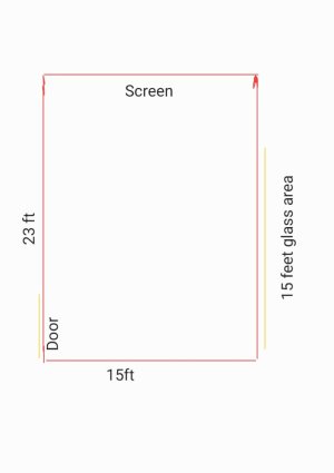

This is a rough drawing of the room, Dedicated room, already has false ceiling. I heard bookshelf speakers give better immersion for atmos than in ceiling, thats why i was considering them
Seems to be big room , IMO If you want to hit reference level you may need to use high sensitivity speakers with higher power handling. If budget is not a constraint look for xtz cinema 8 series speakers for LCR and surrounds .
Regarding Atmos again go for high sensitivity speakers with tiltable option ( for in ceiling the tweeter to be tiltable , if bookshelves then needs to fixed using tiltable brackets aimed at Listening position)
If you can mount bookshelf speakers on ceiling then it will be better IMO.
Acoustics is a must and one of critical item which is ignored. Since you also have a big Glass area on one side of wall you may need to treat it properly.
From the above thread ,I read you have 2 Lakhs for Acoustics which is a very good budget . Please do it.
For subwoofer , I recommend minimum 4 nos for your room size if budget is not constraint or atleast 2 Nos with 15” driver. You can use minidsp 2x4 HD for aligning the same which will give a smooth bass response.
The brands can be Rhythmik, ascendo , xtz cinema series subs .
If you want any further guidance , ping me I know few folks who are professional in installation and also do acoustics which I can refer them if you prefer.
