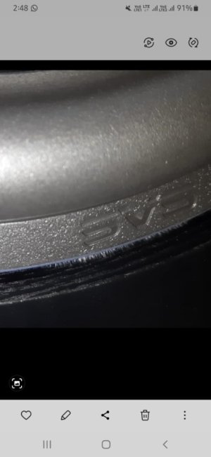

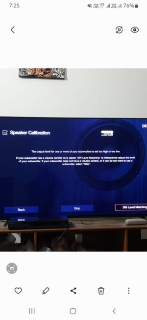

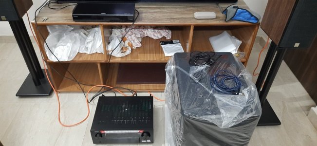

As told by svs customer support i set crossover to 60hz and using lfe only. But the thing is it has made my dali opticon 2 like generic sounding flat. also i ran movie with volume 45 only on denon x4800h and subwoofer never sounded in movie no time to die opening scene. waht is going on. what to do. I ran audessey setup then setup crossover to 60 and then LFE . AT FIRST AUDESSEY SETUP GAVE THIS ERROR. then worked 2nd time in setting up also in 2nd image there is some white fibre coming out on bottom of cone? is this normal

Set subwoofer volume to 50% in the subwoofer, run audyssey. After that, set crossover for all speakers to 80.
Let us know what levels it has set for speakers and sub.
the thing hapeening is that if i sit on my chair my usual place i cant hear bass but when i sit on floor just in front of my subwoofer its deep bass wtf is happening?
I guess you are doing something wrong while calibrating. I had a PC 2000 and it was good for movies.
Assuming your room is small to medium, the subwoofer is very much capable of doing what it is supposed to do.
I would suggest you to read about the basic Audyssey calibration and do it from start. It is not that tough and meant for laymen like us. You may need to do your research on the net and do it patiently. Repeat it till you are satisfied.
It will need a fews hours on running for the sub to deliver. Don't be worried. The lfe on avr should be 80-100.
Did you place your first mike position where you sit on your chair at ear level ? If not, start from there and place the other positions relative to this position. Check the levels set and let us know. With the receiver and speakers that you have, you will get the sound that you are looking for. Get the basics right and then you can tweak the sound to your liking with the numerous features available in your AVR.
