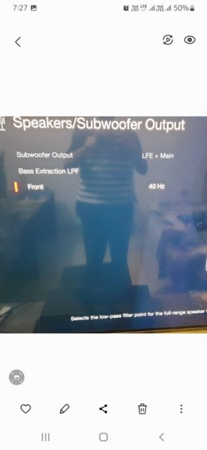

or i use dts hd or mix for movies as well. Also i sat distribution to -20db this setting has appeared and saw this first time
what negative impact it will have
It will send the .1 movie channel bass which is in the range of 3 Hz to 120 Hz to your small bookshelf speakers which, forget LFE, cannot play full range itself. This is used with very large floor standing speakers which might have their own dedicated subwoofer and can reproduce very low frequencies.
With this setting, if you play too loud, there are chances of your speakers and amp getting overstressed and might distort or go into protection mode. Add to that, you have 4 Ohm speakers !!!
Not trying to scare you or anything but if you are using this setting, do it with care.
Edit:
Now that you have finalised your speaker placements, you can try setting your speakers to small, crossover to 80, LFE to LFE and check what difference it will make to the sound. This is the safest settings for your setup and if you are getting good results with it, I recommend that you keep this setting.
first there is no option in my x4800h to set small its FULL/40/60/80/90/100 SO ON and only lfe i dont think it will sound good and i guess in music woofer will not play at ALL
