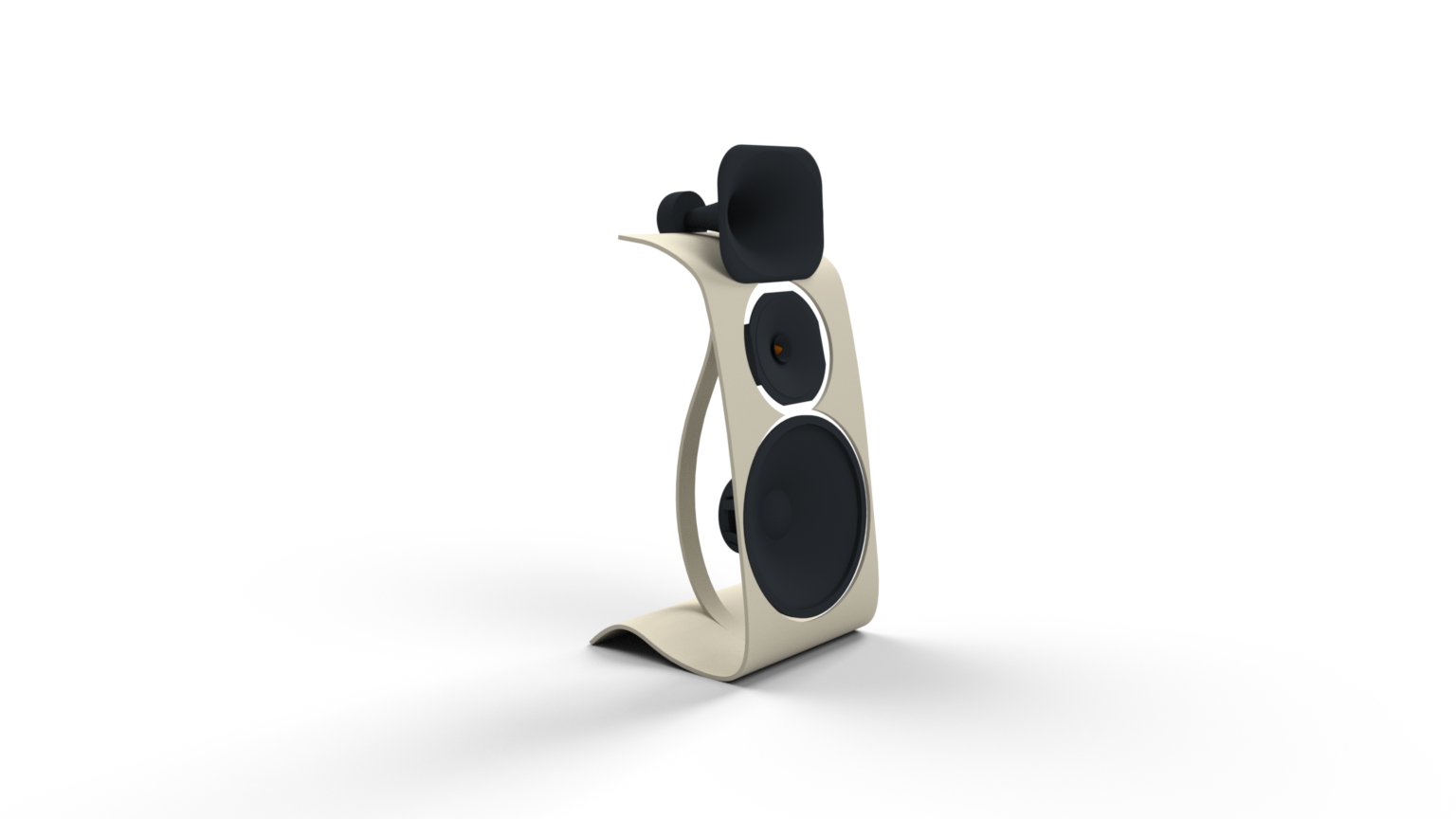

The next step is to try a multi-driver OB. Initially I thought OB simply meant mounting drivers on flat baffles. But as I read through the theory I realised that Linkwitz and others propose that constant directivity speakers like dipoles (https://www.linkwitzlab.com/Constant_directivity_louds.htm) sound better.
An ideal dipole needs to have identical forward and rearward radiation. Typical drivers have cones in front and the magnet and basket assembly at the back. So the rear radiation is not identical to the front. The problem is not so severe for large woofers because the magnet area is smaller compared to the overall driver dimensions. Tweeters pose bigger challenge. To tackle this people try tweeters (facing front and back) or dipole drivers like dipole ribbons.
The other issue for dipoles is that a certain relationship between the driver radius and wavelength must be maintained. The only way to achieve this is to make use of multiple drivers to handle separate frequency ranges. This is evident from Linkwitz's own creation, the LX-521 (http://www.linkwitzlab.com/LX521/Description.htm ). You start with a large woofer for low freq and move to smaller and smaller drivers as you go towards the top end. The baffle is either very small or non-existent as you move up.
Ofcourse multiple drivers brings along with it more complexities in terms of driver matching, crossover design, more amps etc. There are good attempts by several members on diyaudio forum so hope to try something.
