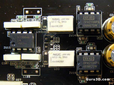

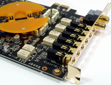

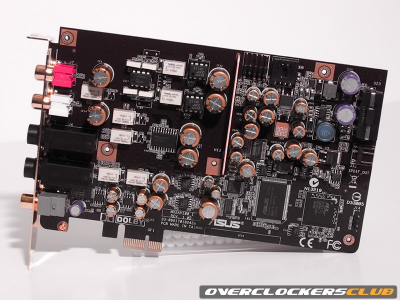

I have D2X. Need to see if it also has.The xonar sound card has 6 relays from NEC japan. You need to remove the metal shield to see it.
Just looked it up. D2X too has 6 relays from NEC japan, visible only when you take out the shield. also found this in a review regarding the function of those relaysI have D2X. Need to see if it also has.
Since most audio gear likes to use higher voltage than the 12 volts you get in a PC, it just might be the case that the extra floppy power is doing something more than just powering all those lights. So, when the D2X doesn't have enough power, you'll hear an audible click. It's from these relays, which disable the sound. In higher end audio equipment relays are used to protect your loudspeakers from a DC spike (the 'thump') when you first turn it on. The D2X does this too. Nice.
