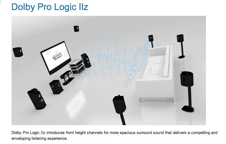

Front heights are best placed above the front speakers, but near the ceiling, slightly angled towards the listening position if you can...
Below is a image for your surround layout...

Here is an on other image for your understanding..
