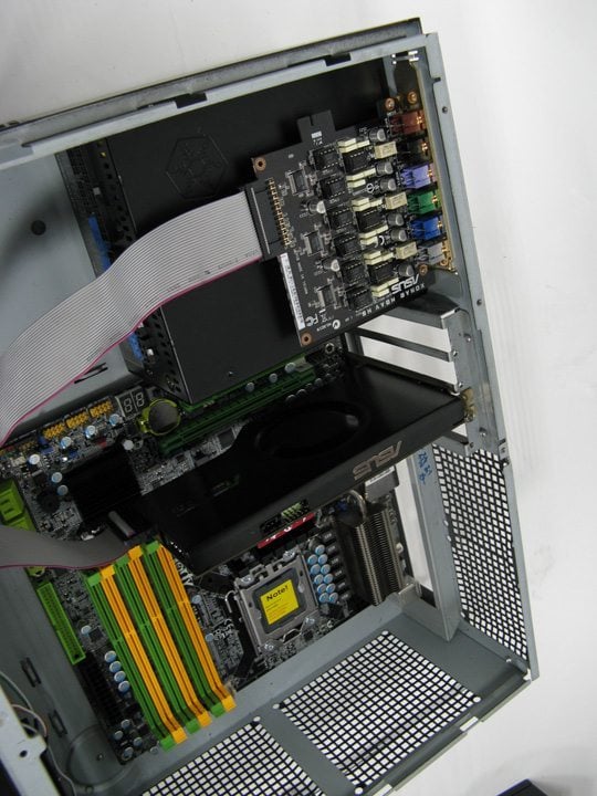

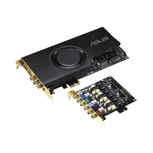

How about Sound Cards like these, which supports HD audio decoding and 7.1 analog output. Quite interesting.
Asus Xonar HDAV1.3 Deluxe

From whatever little research I did, it appears that Claro Halo does not support TrueHD / DTSMA decoding. Only Asus HDAV1.3 deluxe does (but only with TMT software).
