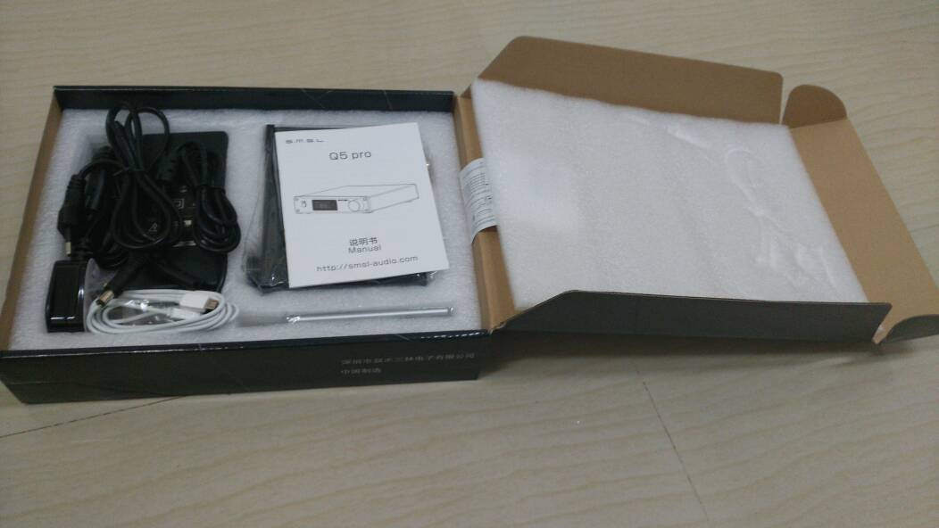

Some more unboxing pics..
Sent from my YU5510A using Tapatalk

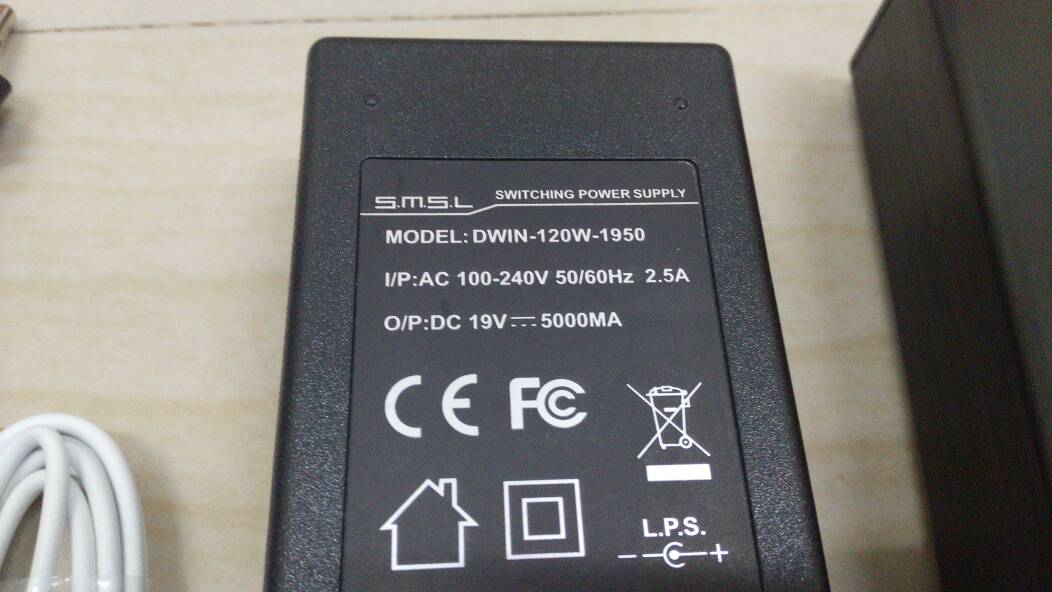

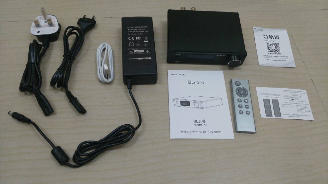

Great. It looks like they gave you twin plugs. One three pin and one two pin?
Sent from my XT1562 using Tapatalk

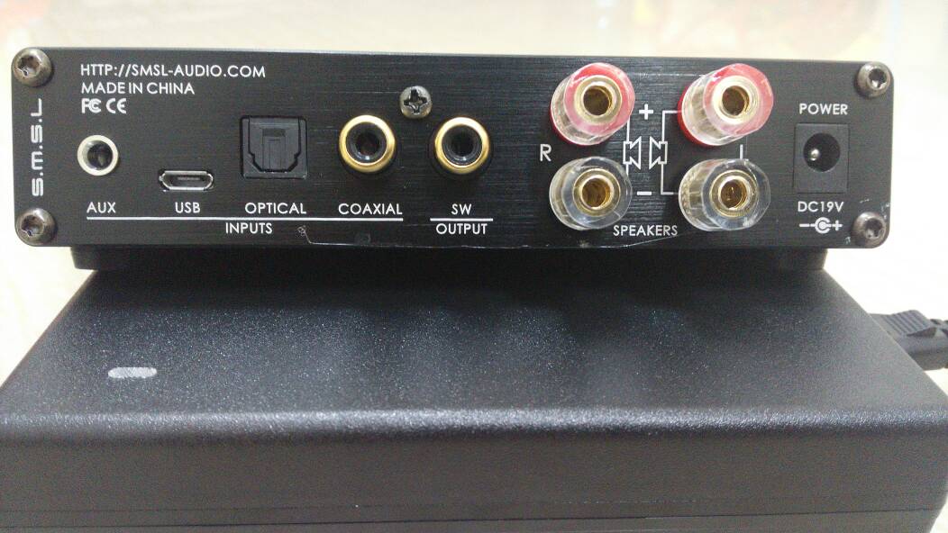

It 'Does' have a DAC and a preamp. just tucked away inside. without them no magic happens.25 watts seem pretty low, 96db efficiency on speakers is awesome though. Should be able to rock out.(at a reasonable volume)
I don't know much technically.. But from general reading, this is what i found..
Q5 pro adopt SA9023 + CS8422 + TAS5508C + TAS5342A
SA9023 - Micro USB receiver
CS8422 - SPDIF input's receiver
TAS5508C - Digital Audio PWM Processor from TI
TAS5342A - "high-performance, integrated stereo digital amplifier power stage" from TI webpage.
I guess there is no DAC in it..
It says 50 watts per channel. Class D amplification(it seems).
Again from googling, " PCM is converted to Pulse with modulation (PWM) signal and then amplified using DDX power output stage, enabling it to drive speakers directly".. I didn't get a hold of this...:ohyeah:
This link gives some information - soundcheck's - audio@vise: Ever heard about Full Digital Amps ??

Am not very sure of the life span... Since this amp has a power adaptor like Laptop/TV, i guess that might be the only equipment that might fail, which i think can be replaced..
Have read been few reports of SMSL Q5 ( 1st v) some failure pieces within shirt span.. But haven't read Q5 Pro issues yet... Hope it lasts for a year atleast...

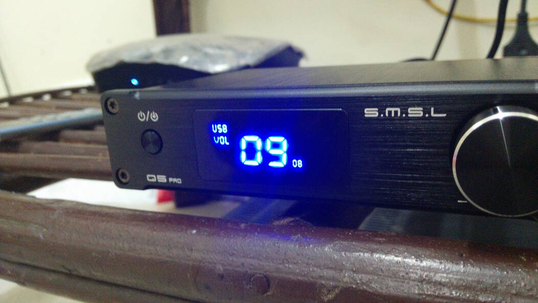

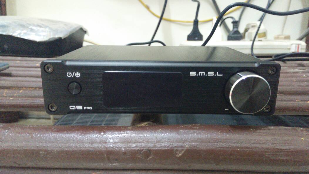

SMSL Q5 Pro - Features
- Direct Digital Amplification (DDX)
- 25W max @ 8 Ohms nad 40W max @ 4 Ohms output
- 3 Digital inputs & 1 Analogue input.
- Optical & co-axial inputs accept 192/24
- Micro USB limited to 96/24
- Sub output.
SMSL Q5 Pro - Functionality
- The supplied USB cable was little hard to plug it in to the amp.
- Front panel is clean with power button & volume knob.
- No physical buttons to switch between inputs.
- toggling the power button switches between the inputs.
- Long pressing the power button, enables switching on & off the amp.
- Toggling the volume knob gives you accees to 8 different preset modes.
- Prest modes (Bass, Super Bass,Heavy Rock, Lite Rock, Jazz. Country, Rap) and EQ0 - FLAT

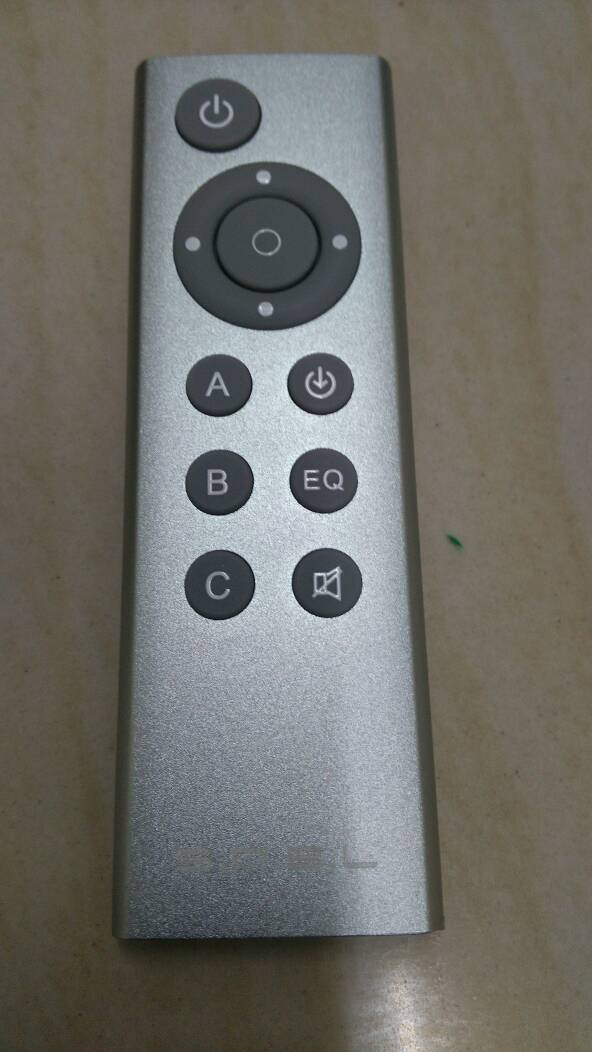

SMSL Q5 Pro - Remote
- Remote is simple and quite easy to hold. Almost the size of waffer's.
- Round D-pad to adjust the volume.
- input switching, EQ & mute are independent buttons.
- some buttons dont have any functionality assigned.
- Guess future versions of the amplifier will have some feature assigned to this butons.

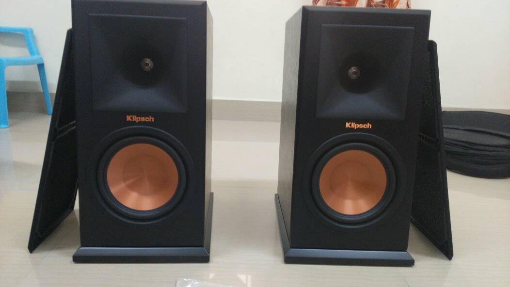

Klipsch RP 160M Bookshelf - Speaker features
- 96db effcient
- Horn loaded titanium tweeter (First time hands on with metal tweeter)
- The horn looks different from the previous generation ones. They start with a circular shape around the tweeter for about 20 - 30mm and then opens to square area.
- 90 x 90 degrees Horizontal x Vertical beam dispersion Horn. Earlier generation used 90 x 60 degrees..
- Looks like the horn have rubber coating to tame the famed harshness of the Klipsch speaker.
- Tactrix shape rear ported.. looks very good.
- Huge for a bookself.. To me it looks like Half the floorstander.
- Heavy @ approx 10 Kgs each..
Klipsch RP160M - Design & Apperance
- From the front, the speaker looks like it is slightly tited backwards. The speaker sits on a base.
- it is speaker base that has been designed in such a way that is slightly tapered towards the back side. Nice touch. Felt like the speaker were saying hello :)
- Trapezoid front grille gets attached to the speaker cabinet magnetically.
- The front of the speaker sides has been designed to deceive a Trapezoid appearance, while it is regular rectangle shape :).. Nice touch.
- The copper woofer looks lovely with grille off..

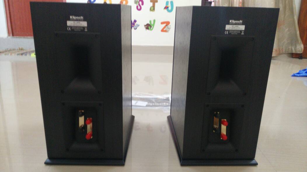

- Surprised to see speaker Binding posts are plastic.
- full marks for design & appearance.. Love it.

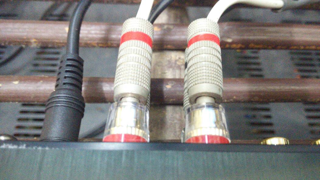

cables & connector - MX banana plugs with Belden speaker cable.
Connectivity - PC connected to the amp via Micro USB.
