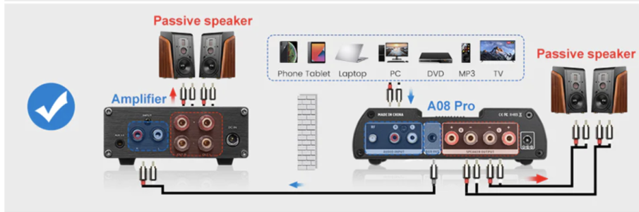

is also give an aux out port which I can connect to subwoofer in future
Can you double check if the AUX port can be used as subwoofer out?
Here is the diagram from the Aiyima official website. It used to create another zone with a separate amplifier.

Ref: AIYIMA A08 Pro
