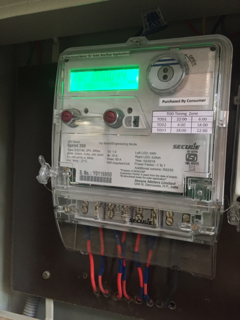

Have noticed no change in the EQ as yet. This is an on-grid system, so that I could export any extra power generated above consumption to Bescom. The bidirectional meter was just setup last week, so I'll have to look at that after a month to see those stats. Solar panels are from Australian Premium Solar and the inverter is Swiss made.

Congrats n nicely done on the roof top.On-grid system really nice with 'Secure' meter,

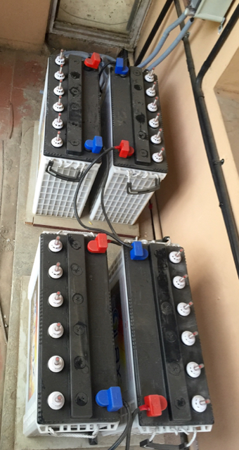

Few clarifications please. Australian Premium Solar 12 panels X 250 watts each in series connection? The inverter is Swiss made Extender XTM 2600Amp-48V hybrid inverter charger. What about the battery. The picture shows 4 tubular batteries 150/180Ah? in parallel connection for 48V. The batteries look Indian.
A solar panel available here whether Indian or chinese has been claimed to last at least 25 years. But what about the battery?
Kindly verify the wattage and connection of the solar panels and the size of the wires for connecting the solar panels and the batteries >10 sq. mm?
What about using VRLA batteries or SMF batteries?

Yes, the batteries are Indian. 40 year warranty on the panels. 5 year warranty on the batteries.

So the capacity of the battery is 210 AH, 4 batteries in parallel connection to make it 48V. Or are you using more number of batteries? Cost of single battery ~20-205K each?
About the size of the wires- is it 10 sq. mm or less?
And about the wattage of the Solar plates: 250 watts isn't it. Parallel or series connection? Should be series connection. Your plates I think are costlier than the ones available in our market whether Indian or chinse.
I have installed some solar plates 150 AH and using VRLA batteries (one is 600 AH and other is 400 AH and was instructed to use 10 sq. mm sized wires to reduce the current loss or something) but not to your extent of 3KVA. Planning to install a 3-5 KVA capacity soon. Hence, would like to know the details more.
