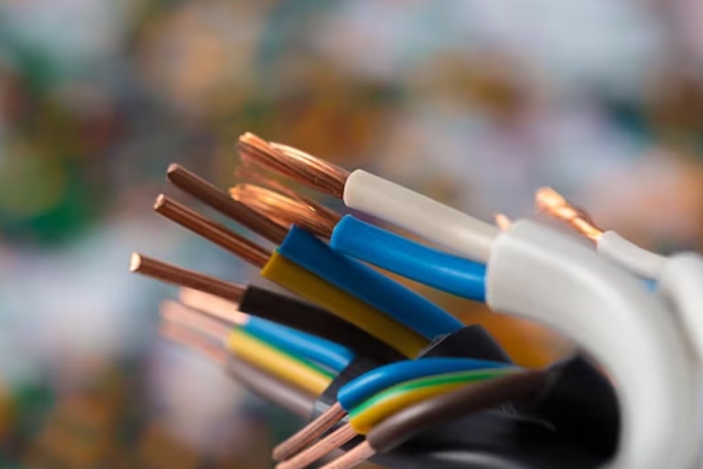

Solid copper 14 AWG cable
But one thing, most folks seem to mention is the skin effect of stranded cables, which can result in a grainier / livelier sound signature. which some might prefer.
Stranded conductors are used to reduce the increase in AC resistance due to skin effect in solid conductors.
Also is "proximity effect" in solid conductors when placed close together and carry an alternating current of any frequency.
That's the reason why power conductors you see hanging on the towers or under the ground are stranded. They are compacted and shaped to reduce the airgap inside. Stranded conductors have less skin and proximity effect.
When it goes to telecom frequencies solid conductors perform better and it is said the stranded conductors have 20 to 50% more attenuation.

What's the thickness of each strand? 12 or 10 AWG?
Nothing to do with the strand. Skin and proximity effects are just the electromagnetic effect of alternating current. Electron diameter is 0.1nm and 22awg is 0.65mm or 650000nm and 12 awg is 2.05mm.
Power cable or line conductors strand diameter can go from a fraction of a mm to several mm.
So any practical wire will have these effects and I believe you can't escape them.
