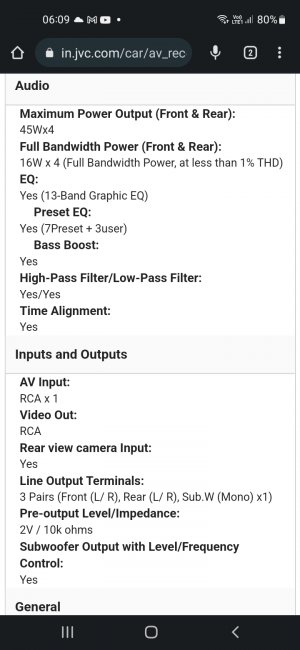

Get a bi-ampable component speaker to avoid external amp. Use amplifed front for tweeters and rear for woofers. Your hu puts 14w power and 2v preouts only, refer the below.

see the crutchfield review ..3 pre outs ie 2 volt front,rear and mono sub
