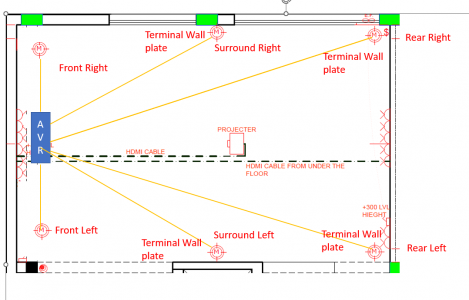

Hi FMs
I need your suggestions/advice on installaing speaker terminal wall plates for 7.1 HT system. At this stage, the conduiting work is going on and I want to provision for wall plates in my lounge that gives me an option to run the speaker cables from floor and I just could connect the speakers with banana plugs later on. Right now I just want to know what are the various options available for wall plates (size for now as I need to install the box either 3x3 or 4x3 or something else). No idea what size is required for 1 set of speaker.
If anyone of you has done something similar or better or any other alternative please let me know.
Thanks.
This is what I have in my mind
