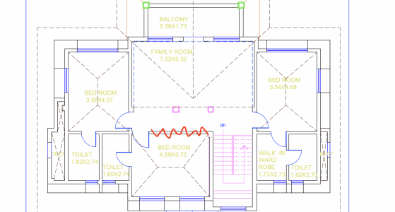

I have a largish room with 15 foot ceilings, and 24 feet in length and 18 feet in depth. It opens up to another room as well (see attached pic).
I am wondering how best to do start the room treatment process. I started by consulting Aural Exchange and they (only) recommended ceiling treatment with panels, no first reflection on walls or corner or back wall diffusors!!
Should I start by doing an REW software thing, or find a new sound guy, or just put some treatment at the corners, sidewalls, and back wall and hope for the best. How have fellow forum members tackled this complex task?
P.S in the attached floor plan (the family room is the music room)

Iam an advocate of room treatment, having sampled the results first hand. Having said that, you have a really large room, so treating the same, will be quite an exercise. Not to mention the expense. Thus, I think an alternate approach might be more suitable. Instead of bass traps to treat the low frequencies, you could consider a multi sub approach to get even bass without booming bass modes. And multi subs actually can work over a wider listening area. Then you only have to treat first reflection points. Since the room is huge, there can be adequate spacing between the speakers. I guess you will have a large sound stage. So diffusion is not required to make it sound bigger still. In my opinion, you can get very good results with absorption at first reflection points.
Hmmmm… by multi sub approach, do you mean adding sub speakers?
Do you like diffusers or absorption in first reflection points?
You should follow Aural's advice. Your high ceilings are a perfect recipe for severe echoes. Just get the ceilings done for now, because it's the most obvious pain point. Rest should be done only after you've set up your audio system, and fully furnished your room. See what is lacking and treat it accordingly, or else it could not only end up being an expensive mistake, but also kill the dynamics.

I was referring to the addition of multiple sub woofers. A minimum of 2 to start with.
As regards diffusion vs absorption. I would add diffusion if the ear to diffuser distance is atleast 10 feet at a minimum. Anything lesser, then I would prefer absorption. I've heard a room with a close to 1 crore system, with an entire back wall , full of expensive quadratic diffusers, 6 feet behind listening position, and it sounded horrendous.
Besides, diffusion needs a larger area to work with. If you add a 2x4 feet absorber at one first reflection point. Then it will take atleast two 2x4 feet diffusers to work at the same place. Besides, diffusers only work from upper mid frequencies, depending on their depth. So my personal preference is a 4 inch broad band absorber with a diffusing scatter plate mounted on top at first reflection points.
15x24 is a pretty big room and follow the principles of speaker placements and you should be fine as your speaker placement and seating position can actually follow the 1/3rds rule or golden ratio ! ie plan to have maybe 5-8 feet behind the front plane of your speakers and behind your head. you will need to anyway leave more space to the sides so 5 feet from the inside sides of the your speakers to the side walls
Are your ceilings sloped or regular ? that is perhaps one area where you can plan for diffusers ( eg terracota tiles) as long as they look aesthetic to break up direct reflection if any
As a confession I do believe that no treatment is the best treatment unless you hear some something specific which cannot be solved via placement since in most cases i see it taking away something much more than what you are trying to solve for :)

Its almost impossible to do or judge the amount of treatment to do without knowing what equipment and furniture will occupy the room. Place thick rugs, a couch with a lot of foam and you've already done some treatment.
The issues (if any) with the room can be tackled only after spending time in a space.
24 feet is absolutely massive. Do you care to get the sound right for half this area or do you need it all to sound right, or, do you care about only the place you will occupy on the sofa or couch.
