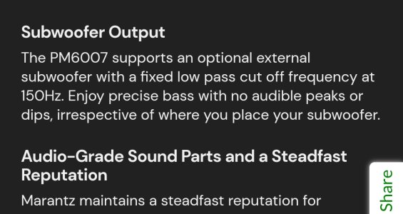

Hi, I found the above note from marantz manual. So this means they say there won't be any delay issue when sub is connected using sub out. There won't be difference when compared with speakers level output?
