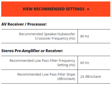

Questions to hfv member: Wharfedale diamond 12.1 frequency range is 65hz - 20khz there is nothing to cut off the lower frequecy, why we need a dsp here. ?
Do we have any microphone and software to detect this delay. ?
