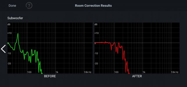

Here is the result after I did audyssey
You can pretty much ignore the Audyssey after (it's a prediction, not an actual measurement). The before Audyssey FR shows you have some pretty significant nulls (100 Hz and below).
You have 3 options:
1. Move your subwoofer to another location where you get a better response (trial and error)
2. If (1) isn't possible or doesn't help, move your listening position to 2/3rds of your room length.
3. If (1)/(2) isn't possible or doesn't help, consider getting an additional sub.
The integration of your center with the sub may also be an issue, but the first step here should be to make the sub's response at your listening position better.

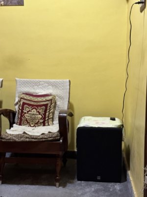

I moved the sub to another location, left side of my couch against the wall, which is a primary listening area. And there is a night and day difference now.
The difference has amazed me, though we sill have multiple listening position in our living room where the impact is inadequate, thus I am planning to add another sub and place that in opposite diagonal to increase the impact.
If you have the flexibility to go duals don't have any second thoughts.
Hey, bro, glad your issue got fixed.
Great it is working for you.
What you have done now is what Atas @prateekatasniya would call near-field. I think you have nailed it.
you have some nasty dips or what we call room modes, also you must be sitting in a NULL....Your graph shows you are missing 60,80,100 hz, which describes most of the slam and kick you are referring to. Change sub placement and run a 20-250 hz sweep and measure with spectroid mobile app to figure out which position has the flattest response

Here's my audessey correction results, as we see, I have a dip at 80 hz, but since all my speakers are crossed at 80 hz, that dip is compensated by the speakers
