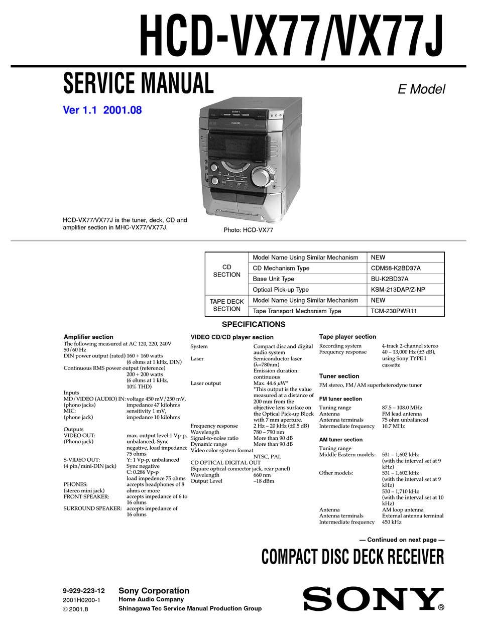

Can someone please suggest to me an amplifier? Following is the link to the manual of my music system so that you guys can check the specification, I wouldn't be sure what all needs to be kept in mind to look for a compatible amp.
Hi, what you have is an all-in-one system. In case you want to hook it to an external amplifier (and speakers), you will need to take line out. so please check if this option is available in this system. however, before investing in a good amplifier, please realize you will have to invest in good speakers and sources also. Probably, speakers are the place to start matching with amp.

What's the issue, is it dead? If yes, better to replace the main unit with another stereo amplifier. As per spec, front speakers are 6-16ohms which most amps can manage.

I am sorry I don't know what "Line out" means here.
I have the speakers of this same system and I want to use them as they sound pretty good despite being 20 years old. Sharing the Picture of the back of both amp and speaker and also sharing the link of video of the system that someone posted on youtube.

Yes, Its dead, it's fan has stopped working and the repair guy said he will have to get the part from sony itself since these parts are difficult to come by nowadays. And though I can have it fixed from a local shop for Rs3-4k but I don't want to do that anymore since I've been getting it fix from the past few years and it doesn't make sense anymore to keep spending money on it. For the same amount or adding a few more bucks gets me new amp that supports aux and bluetooth connectivity would be better now.
