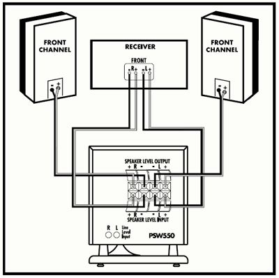

But, if you wish to retain the AVR with passive sub out, you can set fronts as "large" and consider an active subwoofer with speaker level inputs & outputs.. You can then connect the AVR front L & R speaker terminals to subwoofer & run the speaker output terminals from subwoofer to left & right..

i can set front as large but then subwoofer output comes down, u told to connect AVR front L& R terminals to subwoofer and but how to connect my speakers to sub-woofer as there is no output terminals in my subwoofer then how?
Please refer to this connection in the below image..

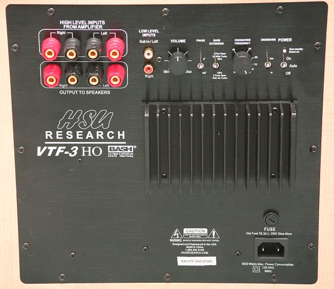

Below image is how a back panel of the subwoofer with high level inputs & outputs would look like..
Not all subwoofers have high level inputs & outputs.. So consider suwboofer models that have high level inputs & outputs..

Not suggested. Active Subs have their own amplification all they need is a Pre Amp signal. Connecting a sub to a powered output can cause damage
this is active sub or passive which has high level input and output?
