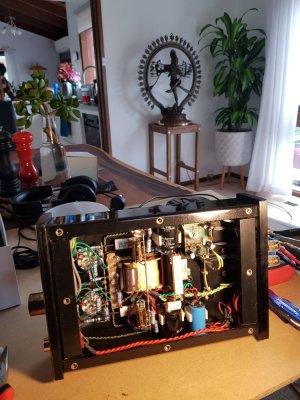

Last trip back home, I found the my old tube amp (courtesy of a good friend) sitting in the cupboard,
No idea about the brand , I searched online and found very little info about it. (GS-Audio GS-Mini 2008 )
Its HEAVY, 2 x heavy Output transformers and 1 power transformer.
80W power consumption for 6W x 2 power output ... suggest Class A
Anyways, I thought I have to try this with my Horn speakers, so lugged it back to Mel.
one of the small tubes were broken, so replaced GE 5670
The power tubes (EL84) no issues, I think they are JJ
found the Volume pot not working, replaced that
power switch burned out, when I powered it ON, (possibly due to it not being used for years), so Bypassed the power switch. expected things to go really bad on the next power on, but its holding steady.
Its got a built-in DAC, (pcm2702E), and head phone out
Hooked it to my laptop and connected a head phone, and no crackle, seems to play well.

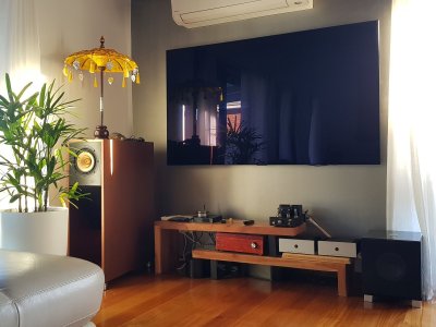

I didn't have any expectations in terms of how it would perform, but was very very pleasantly surprised how it matched up to my DIY horn speakers.
Played it for a few hours, I could smell the amp as it heated up.
now, I connected the REL sub to the chain, (I am still using a stereo to mono Pro mixer to feed input into REL, not yet using the REL high level inputs)
so far, so good, the whole weekend I was listening this setup.
I think I am beginning to understand why Tube amps and Horn speakers are a pair, appreciate the combo, and experience the magic.
Its mighty impressive how low volume I can play, and still be very clear including the details.
Around 10% volume and above, the whole thing is magical.
its not the overly mushy sound signature that seems to be common perception / description of the tube sound, its rather quite good.
