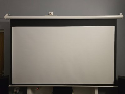

Then I started breaking my head about the screen size and decided on a 100" screen. Checked out various brands and since I wanted to keep the costs low, I found this dealer from Delhi who sold a motorized 100", matte white, 1:1 gain (I think) screen for 7k. They're called Legendary screens. I'm guessing it's white labelled stuff from China. Got it within a week and since I'm blissfully unaware about good screens, it seems decent enough 😁

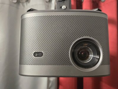

The real headache was positioning the projector. Got the measurements from Projector Central and got it set up. But something went wrong and I have to depend on a bit of keystone correction. But the picture looks good enough. I'll set it up properly when I some time.

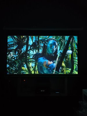

Coming to the picture quality of the projector, I was pleasantly surprised! The colours are vibrant enough. I knew it wasn't going to match the black levels of my TV but the size/immersion of the picture makes up for it.

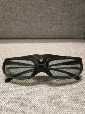

Oh and I got a pair of 3d DLP Link glasses for 1.6k.

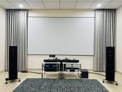

Recently picked up the Valerion VisionMaster Pro2 and paired it with a 133ā€ acoustically woven screen.
For the price, this projector punches way above its weight. In overall image quality, it gets very close to Sony’s entry-level cinema projectors that cost more than 2Ɨ. In my room, the Pro2 actually shows better perceived color pop and a lower black floor, especially in darker scenes.
Setup and alignment took some time since I wanted to avoid keystone correction completely. Once the physical alignment was sorted, sharpness and geometry are spot on, edge to edge.
Even on a 133ā€ AT screen (with black Velvet backing), brightness is more than sufficient, and HDR looks solid after basic tuning.
Overall, very happy with the purchase.

I’m also in the market for a 100-inch screen. Can you share the dealer’s contact details? How has the screen been for you so far?
I'll DM the contact details.
Since I don't know a lot about screens, it seems decent especially for 7k. The only issue I noticed is that the screen is curling at the sides but that seems to be a common issue with non tab-tensioned screens. He sells all kinds of screens BTW.

How did you mount the projector? I got a wall mount from Amazon and the quality is quite bad!

I tested multiple screen samples from Inlight (credit where it’s due - Tushar Anand is extremely helpful) in the ₹18k-₹33k range for a 133ā€ screen, and honestly none of them paired well with a triple-laser projector. The performance ranged from mediocre to outright bad.
Based on my testing, triple-laser projectors really need a matte white screen with a slight beige tint. Anything else tends to distort colours, lower the brightness and hurt overall image quality. I eventually went with an acoustically woven screen from Osteq, which turned out to be a much better match. Their standard matte white fabric wasn’t great, so I had to step up to the AT material.
I didn’t rely on dealer demos alone - I literally carried my projector, Apple TV, and a tripod to multiple demo rooms and friends’ home theaters to test everything myself before finalizing the screen.

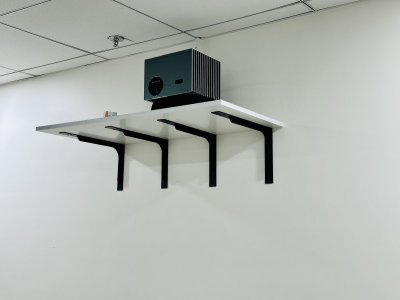

For mounting, I skipped a ceiling mount altogether. The Pro2 has no lens shift, and ceiling mounting severely limits horizontal alignment flexibility. Instead, I installed a wall shelf (IKEA Tolken countertop) using heavy-duty brackets (https://amzn.in/d/brLeT6x - 16ā€) and placed the projector on it. This gave me full control over height and horizontal positioning, which was critical since I choose to install the screen before the shelf went up. Not a pretty looking setup but flexible!

For a moment, I thought you were using a soundbar as the center speaker 😁 And then realized that you've got an AT screen so the center is probably behind that.
It's good that you didn't go with a usual projector mount because the ones we have access to are absolutely crap! I thought of using a shelf like you did but I've got big French windows at the rear so that's kinda out of the question.
I don’t have speakers behind the screen. I just got the AT screen as I liked the quality.
I’m just testing a friends Samsung 990F. For the money I think it’s an extremely impressive sound. Probably more immersive than setups costing ₹3L ish.
For now I’m using McIntosh’s HDMI ARC input and a 2.0 with the Sonus Faber.
Will expand from here. May be an Arcam AVR next and so on…
