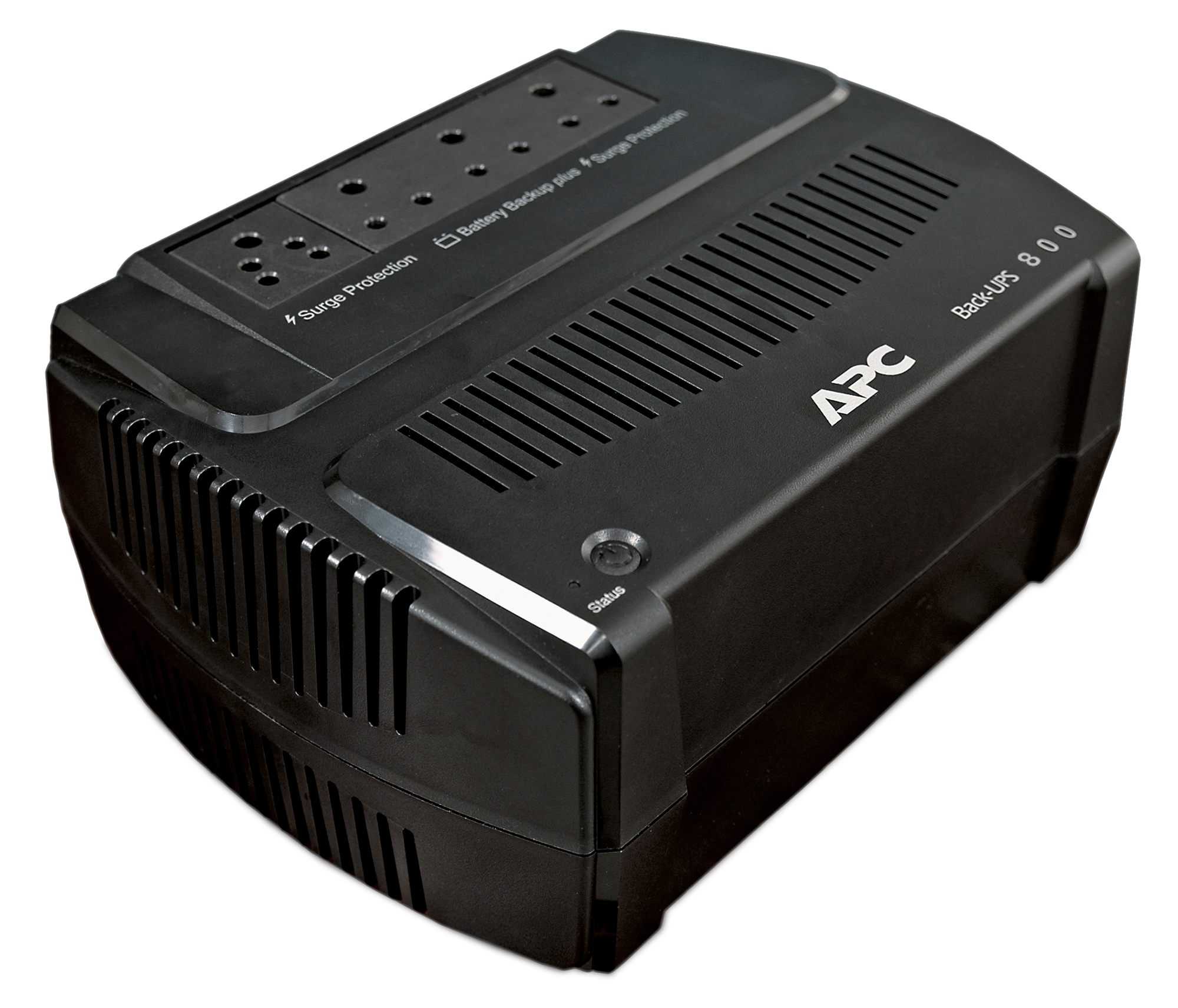

I used this one in the past with my Denon (although a different model) AVR without any issues.
