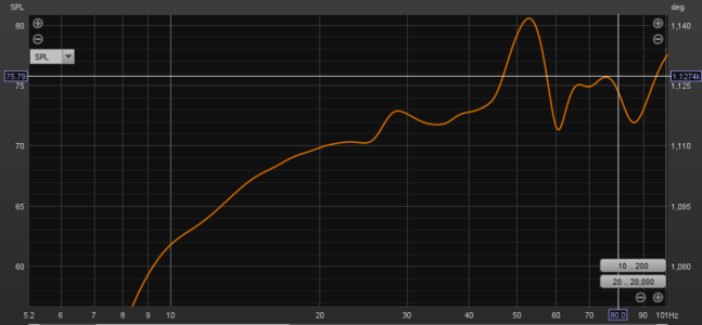

Can't disagree - there's no replacement for displacement. The lowest bass frequencies provides the foundation and adds to the soundstage and i suspect the reason why Spendor's do it so well is because they have a very linear roll off all the way down to 20hz and beyond.
Low volume notwithstanding, this is the roll off of the Spendor Classic 2/3 below 100hz - room nodes aside, notice that the speaker is only -6db down at 20hz from that of 80hz.
