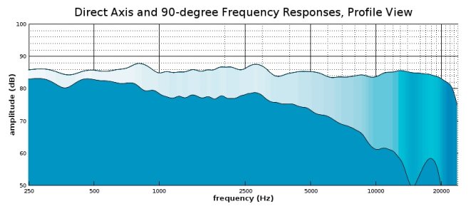

I agree that it can vary by speakers. If I chart waterfall graph, the high frequency roll off is not exactly same as midrange on varying off axis
I just attached some random profile view from internet just for reference. The highs tend to roll off in a different way when compared to mids in off axis. And the base notes don't care about off axis at all. This is what I meant the change in Imaging.

Off-axis rolloff of highs is natural. The directivity os getting affected here and because of that the mids and highs are not able to keep directional cues offaxis. This can be reduced by minor toeing and listening closer to the speakers
