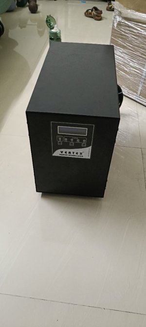

I am using the NKB technology stablizer for few months. It is working well, not worried anymore about the voltage fluctuations for my hi-fi gear
How is the noise level (if any)?? Can it be used in the same room ?
A servo stab will only make an audible beeping sound while correcting voltage and will remain silent otherwise. So every time the voltage goes beyond the operational range, it will beep. Pricewise is cheaper compared to a static stab.
A static voltage is silent in its operation and is quicker than a servo in voltage correction. It has no moving parts inside hence no servicing required for many years. The flip side is that it is quite expensive compared to a servo stab.

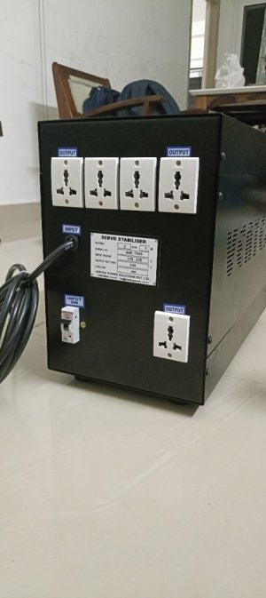

No humming noise, i am.using it on the same room. Infact I am using it as a db also, taking power for the CDP amp pre and dac as there is multiple universal sockets are there.
In case of change in input voltage the servo clicking sound shall come, but it's very minimal.
