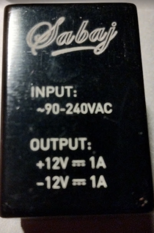

Recently (few months back) I repaired Sabaj Dac for one of our FM. Same issue. The SMPS is designed for 90-240 VAC. It went burst and was made operational by using a SMPS from meanwell with the same output voltages.
