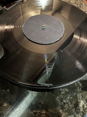

Imagine my horror then, when I ripped off the shrink wrap on a brand new album to see this:
What’s been going on in the last 35 years? We’re all carrying supercomputers in our pockets, but records are still being made in the 19th century? Well, whatever the reason, I figured I would have to get some kind of record cleaning machine. And so the search began.

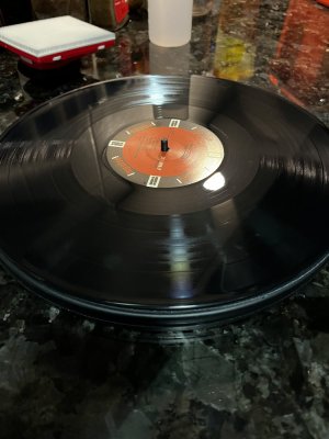

Ah, well… unlike the DIY experts on this forum, I’m pretty useless with my hands. Could there be some other jugaad solution? That’s when I stumbled across the Vinyl Vac. The video at the end of this post covers the entire process, so I won’t go into the details here. Suffice to say, it works really well. Here’s a shot of the same record above, after a single spin with the Vinyl Vac.

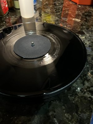

Why is Ilfotol important? Because you need a surfactant to break up the surface tension of the fluid. That’s the only way it’s going to get deep into the grooves. Here’s a pic of a record that’s covered with the cleaning fluid I made from the above recipe.
If you can’t find Ilfotol anywhere, do check out the other options online. Dishwashing liquid, Tergikleen and Triton X100 are some of the other popular choices. But make sure you do a thorough distilled water rinse before vacuuming the stuff off, to ensure you don’t leave any residue on the vinyl.
