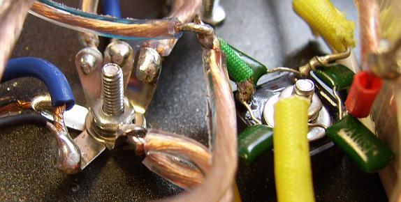

Re: Now what to use for star grounding?
OK, My preamp is singing now - on a temporary chassis once again!! (I've been sleeping late and waking late like 10am since last 3 months and this has resulted in my chassis building project being postponed!)
Now I want to plan the wiring runs and layout inside the new chassis so the final work does not look so grotesque. I've got two places with star grounding.
One is chassis ground with tranny, L+R rca-in signal ground, pcb grounding from the circuit and mains earth. The other star is signal grounds of rca-in L+R to L+R grounds of volume-pot, all of which go into pcb totalling 5 wires! Needless to say its one big messy looking layout! But the hum is completely taken care of - even the one that existed in my earlier build. ( Very faint buzz from RF/mains exists though!)
I need some metal fitting into which I can run 5 wires in cleanly without struggling to solder them all in one tiny place. It should lend itself to neatness and prevent having to solder multiple wires in one place.
Any suggestions? I am thinking tiny spades or earth lugs per wire all going into one screw into a 6mm thick copper strip 1" wide and long (assuming a wooden chassis)? This way I can solder each wire to a spade or lug individually instead of struggling to solder one wire on top of another and watching them come off with the heat applied for the next round of soldering!! (took me %#@$%%%@ 30 mins to solder 5 wires together onto one earthing lug!!)
But if you folks know of any popular trick or mechanical fastener used in electronics let me know. I also need to figure out how I will "staple" the wires to run neatly along a perimeter of the chassis. Any tips?

Here is a look inside my assembled Pre :)
The two tubes in the front are JJ/Tesla from former Checz republic. The one in the back is a Shugang. All 12AU7s.
