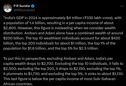

Thank you for the enlightening information, @mbhangui . Atleast the maharajahs and emperors of yore had to fight battles and wars. Those today have absolutely no worries. The pic below and the link illustrate the reality of the "largest democracy" in the world
