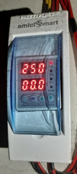

My entire society went to the local Electricity board armed with voltage readings throughout the day/night which showed voltages upto 250 volts.
Same here , it goes upto 255V AC sometimes during night time and is around 240VAC during daytime. I have an old Technics SA380 with STK 4191 and the voltage across filter caps is +/- 52 VDC! I don't know how come it still plays fine.
Maybe they are supplying higher voltages than nominal to areas nearer to substation to compensate for the lower than nominal votages in areas situated farther from substation.

Yes. It was 230 +- 5%. Now it is 240 +-10%. We are now same as Afghanistan. I have posted the IEC standards before and after in this very forum. You may want to search for it and read it. At least in my complex, no of people losing equipment because of high voltages is not funny

Anyways 250V is still within +/-10% range of 230V, so I'm doubtful things will ever change. Also higher voltages results in higher utillity bills (devices powered by SMPS are an exception)

That will happen when 750 watts will be consumed when voltage is 250v. What I'm showing is when your voltage is 230v and the power consumption is 750 watts, what will be the current flow. It will be 3.26 Amps. Now if you increase the voltage from 230v to 250v, your current will increase proportionally and power consumption will become 885 watts. So net effect of changing the voltage from 230v to 250v will result in increase by 135 watts. This 135 watts is the extra chappati that I explained earlier.
Can I offset the effect of increased voltage by installing a good quality powerful(3KVA - 5KVA) mainline stabilizer?
Yes. There will be some loss with the stabilizer. So your net reduction of electricity bill will be a bit reduced by the stabilizer loss. This can be calculated only by measuring the current being (full load) consumed before using the stabilizer and current consumed after using the stabilizer.
