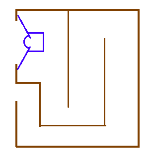

TL stands for "Transmission Line"
A TL sub may looks like this
