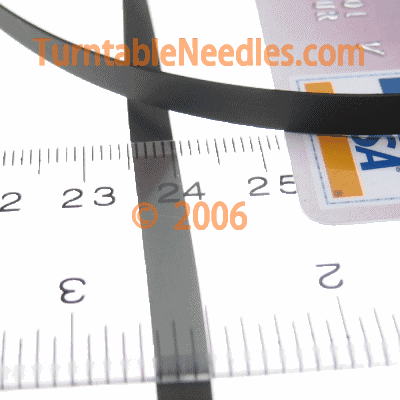

I have installed new 220v transformer in deck it is giving 40v output instead of 33.4 v output of 100v transformer deck is working fine also changed idler tire and pinch roller as they were slippery stopping the play back and rolling out tape then checked belts of deck they are slightly loose should I order new belts? from which site is recommended?
