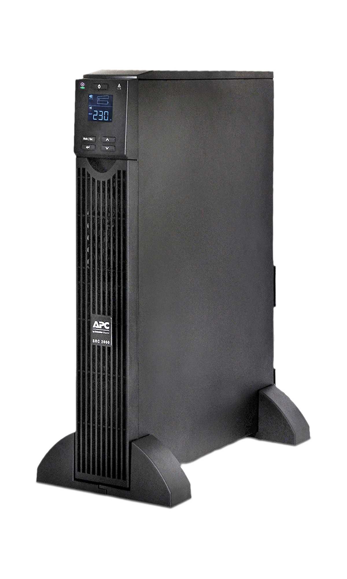

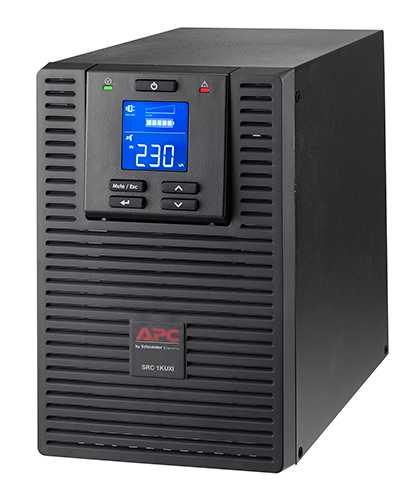

This should suffice your need, it's based on double conversion so will always provide 100% pure sinewave output. FYI, they usually make a lot of noise so you might have to put them in a different room.
I have the same one.. I have kept it in another room due to the noise....
Yeah thats the problem
