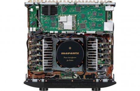

A laptop cooler with five fans (four on the edges and one in the center) like the one I linked appears to work better than the single/two fan ones to keep the HDMI and related processing section right at the back of the AVR nice and cool. At the end of a four hour run, I've noticed that the AVR case in the centre is warm to the touch (being cooled by the larger and slower fan) while the AVR case at the back and front are cool since that's where the smaller higher speed fans are. Without the cooling pad and after a four hour run, the entire case of my AVR is hot to the touch even though it sits right out in the open and is not enclosed at all.
On a separate but related note, the SR8015 has some internal cooling fans in the center. This post https://www.audiosciencereview.com/...marantz-sr8015-review-home-theater-avr.24005/ at the famous/infamous ASR forum states that the fans don't appear to turn on during typical usage.
The picture is the guts of the SR8015 where the fans are visible. Peeking through the top of the SR6015 I can see that it too has similar fans.
