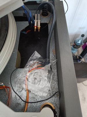

Hi!
I took off the armboard to take a photo of some missing links. The wires with contacts on i guess goes to the armlift that is not mounted on this turntable. Then there is wires cut off that shall go to the missing xlr(where the cable from the SME arm is going trough)
But there is a set of rca plugs on a cable going under the chassis. I do not know where they end. Is this tonearm cables going to step up transformers, trough riaa board and then to the xlr on the back of the turntable?
As always, happy for answers :-)
Hi!
Some one has meddled with the setup. The original EMT tonearm will have a 7 pin round connector and the cable goes to the preamp board. By design the preamp board is a MM board. For MC, there is a small daughter board (called pre pre amp) that is fixed to the preamp board and then it can take MC cartridges. SME 3009 is not the ideal choice. Get a EMT 929 tonearm and restore to original condition.
