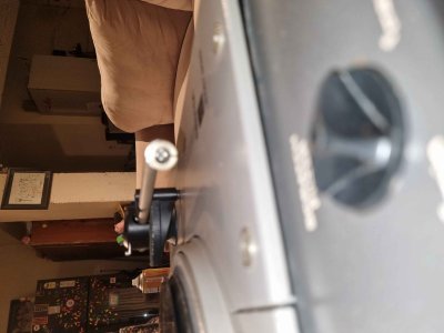

Dear Anil (and other members),
I'm a first time poster here, thank-you for your generous offer of advise and constributions on EMT products!
My interest in audio equipment has steadily grown from well known mid-fi brands to a mixture of vintage and DIY. I recently bought a EMT 929 arm - my entry to the brand. I've mostly owned British equipment, but now very curious to hear renowned Swiss/German gear. I also have a couple of Thorens Turntables (TD126 Mk2 & 3) and was thinking of trying the arm with them.
My first question is around the installation of the arm. I've attached an image, unfortunately it wasn't supplied with the Black mounting base. I've seen these listed for sale online, but I want to make sure it will work.
How is the arm fixed into the base? There are 2 grommet screws in the base, that seem to match up with 2 drilled indentations in the arm shaft. However these are located near the bottom, and would result in the arm sitting too high above the plinth. Is the idea that the arm can slide further down (adjust VTA) and the grub screws are used on any part of the shaft to hold the arm in place? I don't want to screw hard into the polished metal, or is this design?
Many thanks for your consideration and advice,
Lancaster
EMT tonearm sits into a metal base which would have 2 grub screws. They hold the cylinder on the tonearm and height is adjustable (VTA). The design is that the grub screws hold onto the polished cylinder. Only caution I would advice is not to overtighten the grub screws and damage the tonearm cylinder.

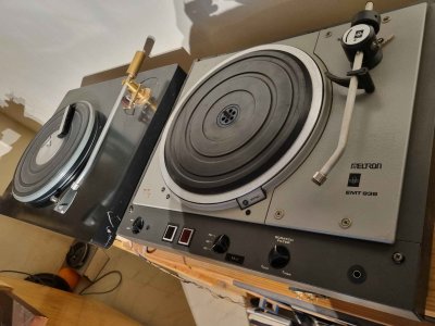

Hello members,

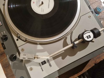

I have bought a EMT 938 table and the phono section and the amplifier section work. The arm 929 seems alright too. While the previous owner showed me a demo with a not so highly regarded Classic 700 mm cart, I am now in search for a mm cart for it. I have an emt type headshell which will accept any cartrdige. I was told this is a universal tonearm. Would anybody know from the attached photo?
The internet told me of shure sc35c which is a low compliance and heavy tracking weight (4 to 5g) cartridge. This seems to have been used by the broadcasting stations. Rolls off top end and good bass.
These were very inexpensive 5 years ago but now cost about 15k after the closure of Shure. The tsd15 is out of budget right now.
I would like to try the internal phono of the EMT which is MM and hence am looking for an inexpensive mm cart. I don't want to commit too much in terms of price as I am not sure how well the phono section works since it hasnt been recapped or looked into but the good news is, it works..
My question is are there any modern equivalent carts in similar price range that might be worth trying? OR should i stick to a tried and tested combo in the shure sc35c?
Will appreciate your advice and inputs.
Thanks

You seem to have the earlier model of Meltron EMT 938. The later versions did not have a scratch filter. The tonearm is a EMT 929 tonearm with EMT cartridge pinout and not SME pinout. Because the EMT 929 has a longer tonearm tube, for geometry reasons, the headshell is supposed to be a small headshell. You seem to enough space on the modified Pioneer headshell. You can use any high tracking force MM cartridge on this. The most popular is Stanton 500 cartridge. They must be available. Shure SC35 is good too. The phono preamp inside the EMT is one of the best and it cannot be bested by many high priced external phono preamps.
All the best.
Cheers
Anil
@anilva thanks.i was hoping you would comment. Appreciate it. I have read your previous posts on the emt and they were a great help.
So yes the stanton and the shure are popular inexpensive choices. May i ask if you have used any other mm carts on this table or did you always go with to the mc tsd15? I have seen multiple users say emt is a complete package and don't try to best or separate the sun of the parts. The denon 103 is another popular choice but I want to use the inbuilt mm phono and i dont see myself buying the mc card.
So I understand now, this is not the universal tonearm but the modified pioneer headshell with the diamond pattern which now allows me to use lots of other carts. What does a iniversal tonearm look like? Might get a
Audiosilente headshell at a later stage.
Also thinking of getting a cable to outboard the phono just to satisfy my curiosity. The anadialogue video tells you how to Diy one else I see a dusch cable listed on ebay.

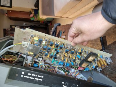

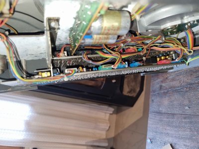

Another thing I opened up the table and what an engineering marvel. The solder on the boards is stil new with a silvery sheen. After all these years. Wow. Attaching photos just for viewing pleasure.

somehow putting a cheap MM on an EMT 938 feels like putting entry level apollo tyre on a merc :)
@arj
The stanton and the shure sc35c are tried and tested combinations and the internet has multiple people who have before me used this combo.So not a bad idea to check.
Also this table hasnt been looked up and restored by the 2 guys who are in Europe so I will tread cautiously. :)
The best option is to buy a MC daughter card for MM PCB and connect a TSD15 for full experience of EMT. Otherwise you can use a DL103 as a stop gap on the modified pioneer headshell.
The last option is to run the MM board as it is with a Stanton or a Shure MM cartridge. BTW AIR has been using stanton cartridge all these years. Amongst multiple EMTs that I have, one of the favourite go-to TT is the EMT938 MM with Stanton 500. I bought a Jico stylus for it. Its terrific. It's also great for playing not so good condition LPs. Playing them on a TSD15 is risky.
The cable from the 5pin round EMT socket to RCA out is not easy to make. The connectors are unique. Best is to get it from Dusch.
No big maintenance is required. You can get the electrolytic caps replaced by an decent electronic technician and also replace the small yellow tantalum capacitors on the audio board as they tend to get short with age and will cause smoke and fumes and the board dead at some point in time. Unfortunately they are used across the power supply rail for filtering.
very interesting insight about AIR using the Stanton (assume it's the 500). In the past, I acquired some SP10s from a radio station in Australia, all of them came with Sedco/Syntec S220 tonearms and with Stanton 500s on universal head shells (and Sedco BA-3c external phonostage installations). Hence, seems like other broadcasters preferred it too. To my ears, the Stanton 500 sounded like a lower output version of the Shure M44-7, albeit with slightly less bass response.
My 2 cents, radio stations use very high-quality equipment, but generally the sound coming out of a radio station is rarely high quality. Hence, the choice of cartridge for broadcast turntables in radio stations, was generally based on a different set of factors. For home listening, with a decent chain, these factors may not be relevant. For example, when I moved from Stanton 500 in use with the SP10, to Shure V15 III, it was like coming out of a black-and-white picture and entering the world of colour :). Arj is spot-on.

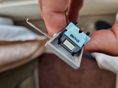

I got lucky and got 2 of these new. Early days but the Shure Sc35c seems a fine cart. Good reco by Herb Reichert too.
